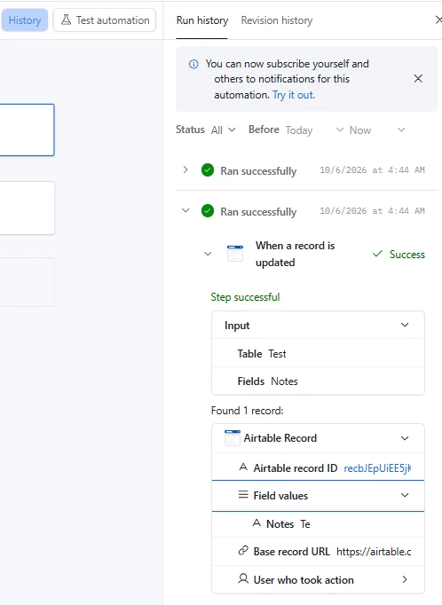

Alexey_Gusev
Forum|alt.badge.img+25
You should review history.
If you update text field by typing new value, probably it runs in the middle of typing, as ​@ScottWorld said. You should update by pasting the whole value or use other field type with “instant” change like single-select etc. Example - I’m trying to type “Test” in “Notes” field in the similar case.
