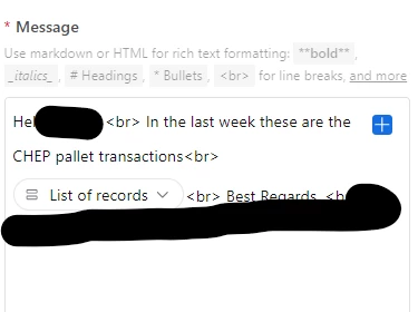

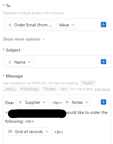

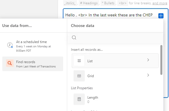

Hi @Scott_Haiduc ,
I include record information in the email message as a [List of Records] or a [Grid of Records]. Here are some photos to demonstrate.
Click the blue + to add the token to whichever field you need the details in.
or

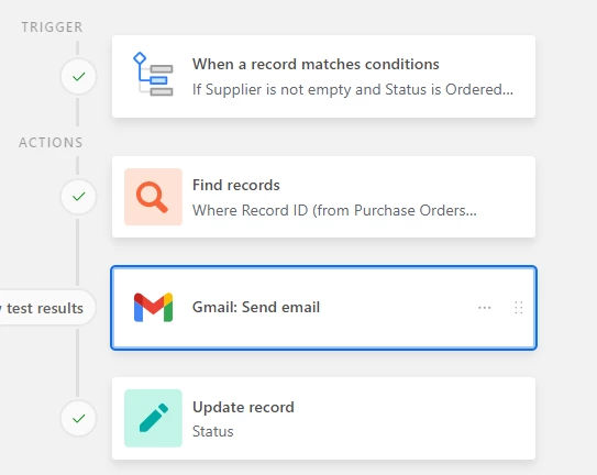

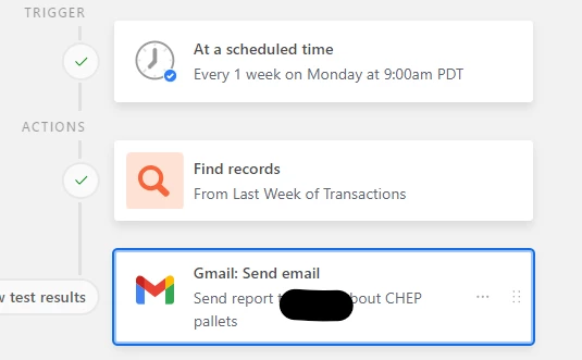

This way you can add details about the records from any step in your automation or linked records to any step in your automation.
