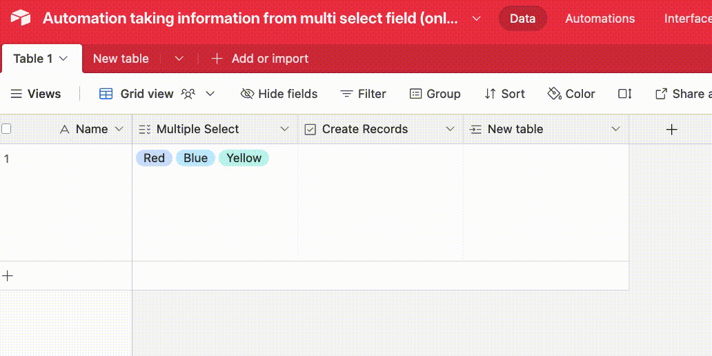

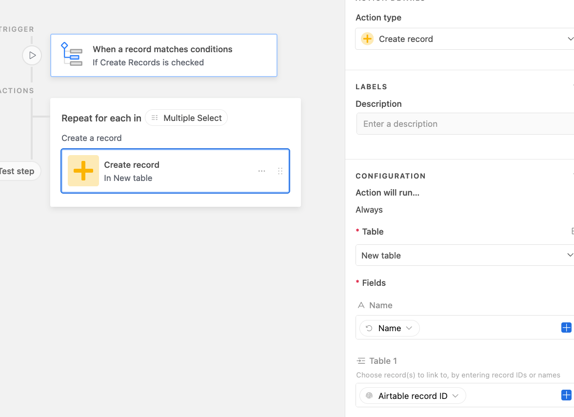

Yeah it is, you could create an automation that'll take the multiple select field's values and use it in a repeating group like this:
Which would result in this:
Link to base
You mentioned that you want the automation to trigger when a record is created in Table A, and so I assume the multiple select field is fully populated on creation of the record in Table A?  If that's the case, you'll notice that in my automation it's set up to trigger when the checkbox field is checked, but you can just change it to "When record created" and it'll work fine
