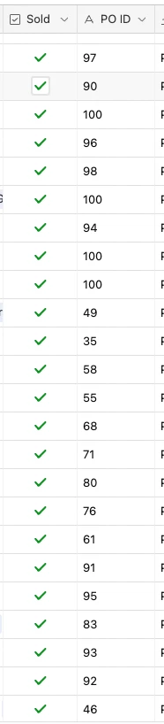

I have an automation that creates a numbered sequence once a checkbox is ticked (e.g. 1, 2, 3) by updating a field using 'Length of records".
The issue is it has maxed out at a 100 and I need it to continue. Does anyone know how I can continue this automation beyond 100?

Is that "Length of records" value coming from a "Find records" action?  If so, that's due to "Find records" only being able to find 100 records at a time
Possible workarounds involve using a script to find the records instead, or modifying your base to show the count, depending on what you're trying to do / comfortable with
