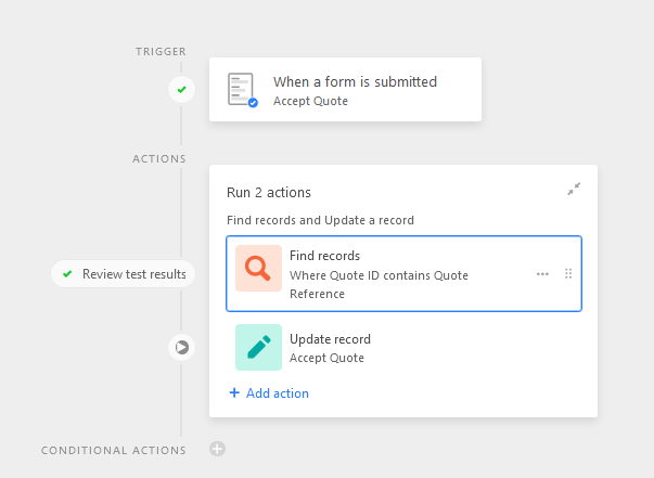

So long as the "Find records" action only returns one record matching the search condition, you can create a simple no-script Automation that will take form data from Table B, check for a match in Table A (via the Find Records action), and then update that matched record with the form data.
If multiple matches are found, this is where you'll need to employ some scripting to handle the array of records. Perhaps you'll need to simply match the first record (and delete the others?)
