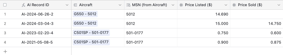

I am working on in a table whose purpose is to have all aircraft on market & recently sold as a mechanism to build an MLS type system. I am trying to create an automation to delete a record IF a record that is being imported/create whose MSN matches and the Sold Price was filed where as before it might have been blank (signifying the aircraft was available). For ease of explanation here is a simple table structure to reference. What is the best way to achieve that?
The question I have is that is I create a new record (via import of records) and the Aircraft Serial matches one t

Hmm, would it be right to say that, if a record has an "MSN (from Aircraft)" value, as well as a "Price Sold ($)" value you want it to be deleted automatically?  So with reference to the screenshot you've provided, records 2, 3, and 4 should be deleted?

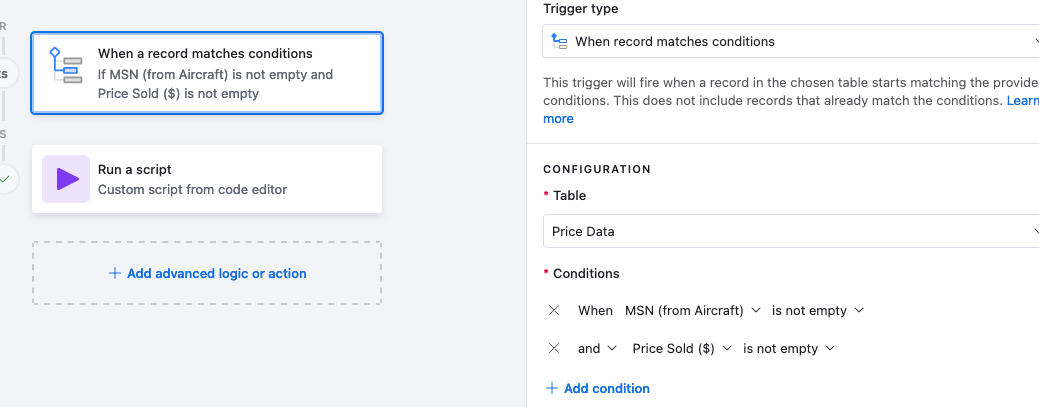

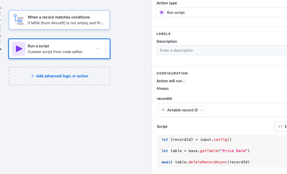

If so, you can try an automation that triggers when "MSN (from Aircraft) and "Price Sold ($)" are not empty, and its action would be to run a script to delete that record:

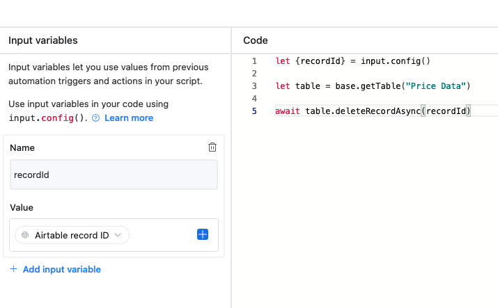

let {recordId} = input.config() let table = base.getTable("[NAME OF THE TABLE YOU WANT TO DELETE RECORDS FROM]") await table.deleteRecordAsync(recordId)
Link to base
Note that this'll use one automation run per record deletion so if you're importing and deleting a lot of stuff frequently this might be an issue, and we'd need to find an alternative method to handle this.  For your reference, a Teams plan has 25k automation runs per month!
