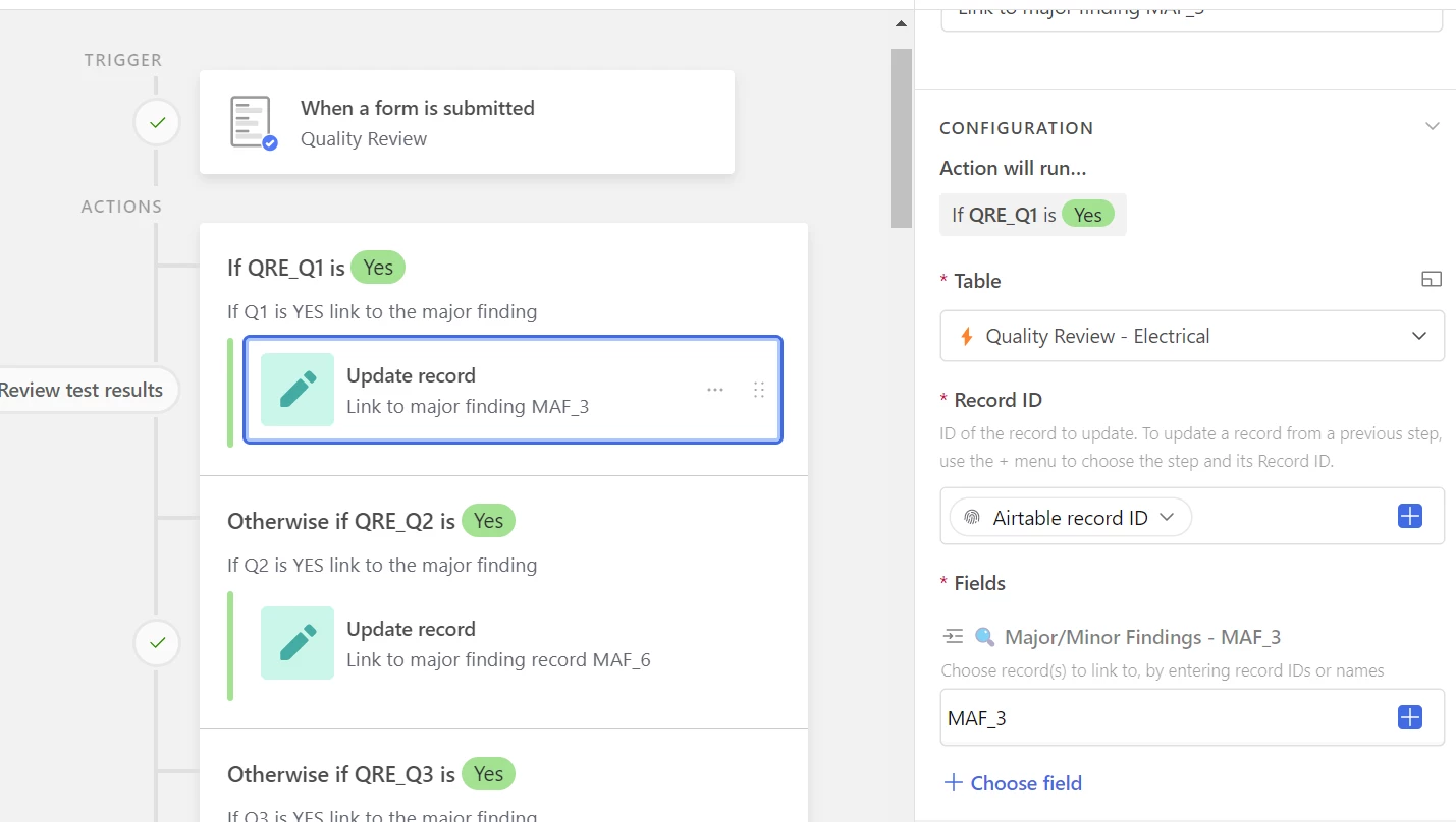

Hi all,
Wanted to see if anyone had any ideas why the following isn't working.
Background
  • I have a table of issues each with a specific code

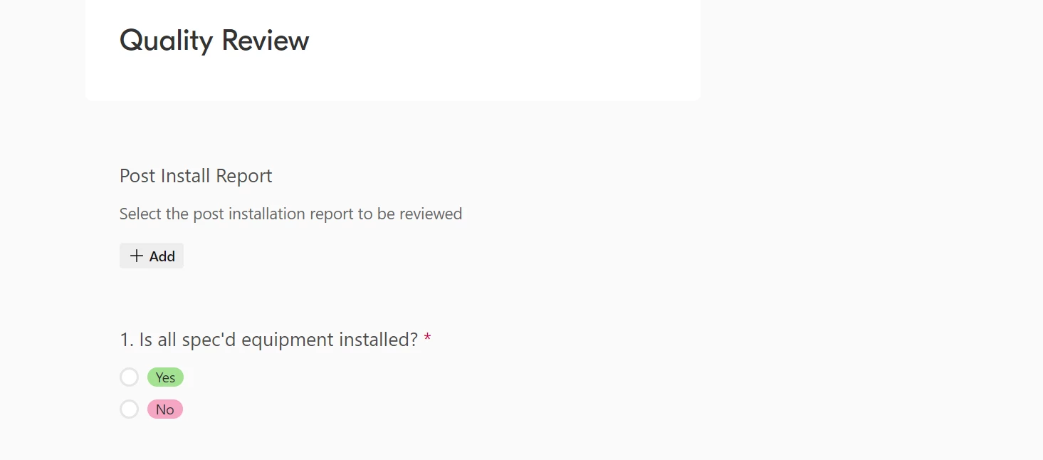

  • I also have a table that takes form submissions for the yes/no output of questions in the form.
  • When the a question is answered "yes" I want to create a link in a lookup field to the issues table to record the specific issue found.

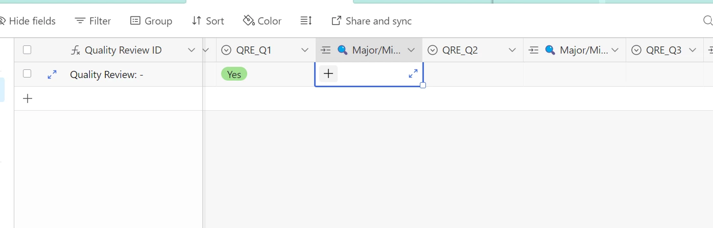

Issue
  • Upon the form submission the automation I have set up only works for the first question. After the first question none of the other questions answered yes are linking to the specific record.
Any ideas why this is?

Ah, once the first criteria gets met the automation stops running I'm afraid.
If you could provide some screenshots of your form table and your issues table perhaps we could find a workaround?
Good to know re the automation.
In the form table I am trying to automate the linking of specific records from another table if the question in the form is answered yes. Essentially the specific question will always link to the same record. There's around 14 questions in total.
