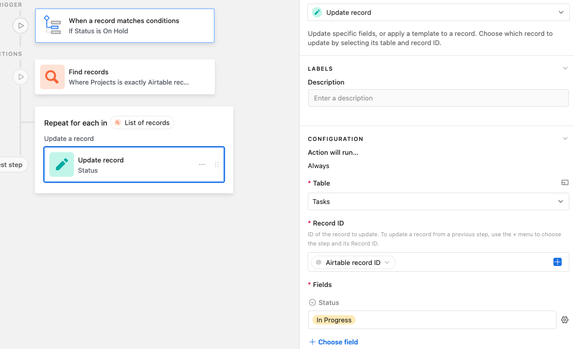

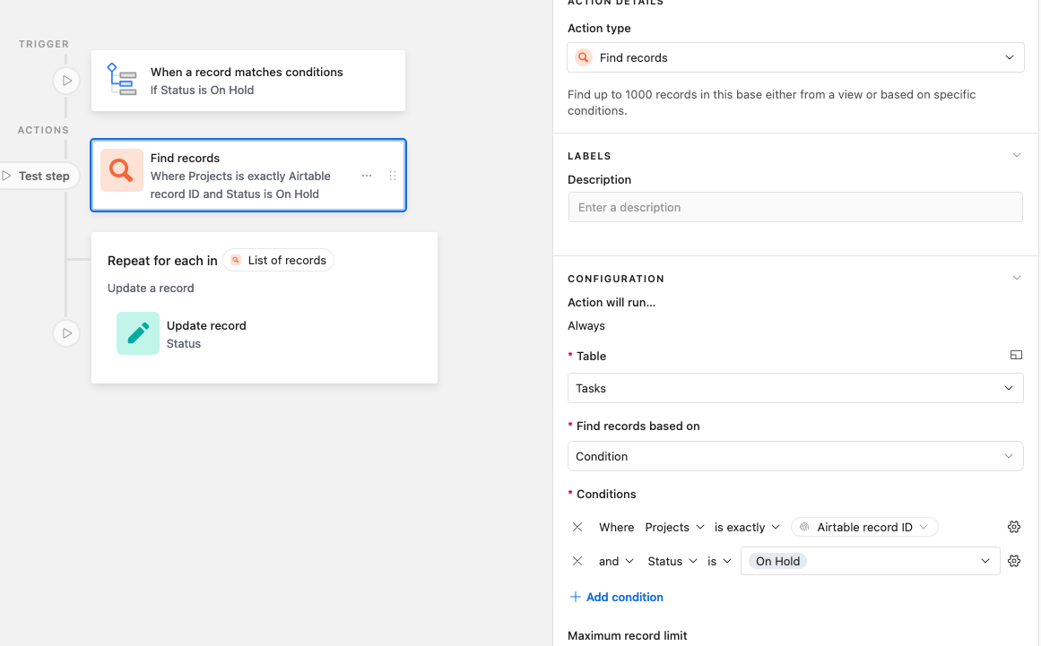

Hmm, I'd suggest using a "Find Record" action to look for Task records that are linked to the triggering Project that have a Status of "On Hold":
And then using a Repeating Group to update all those "On Hold" Tasks to be "In Progress":
