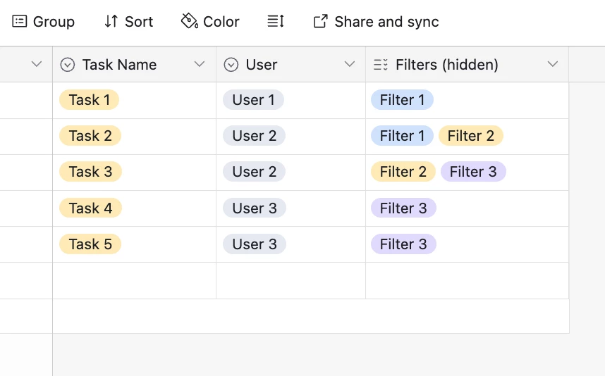

I've found an alternate solution by utilizing batch update extension instead of automations - but - I'll still try to clarify my original post, sometimes it's difficult explaining Airtable structures using only text.
I'm using a table such as this for my online portal. The Tasks and Users are visible on the table but the Filters are not since it is being used for a dropdown menu to filter the visible table data. Since I have hundreds of these records, I wanted an automation to look at my Tasks and depending on what Task # it is, add the Filter options that apply to that specific Task #. The problem I'm running into is that if some of the records already have a single filter that I added at one point manually, when I set up the automation to add another filter option, it removes the filter that was there before and adds the new one. It treats the multi-select field as if it were a single select. The other issue being the automation doesn't trigger by just looking at my current dataset, I have to remove the Task # and add it again for it to register.

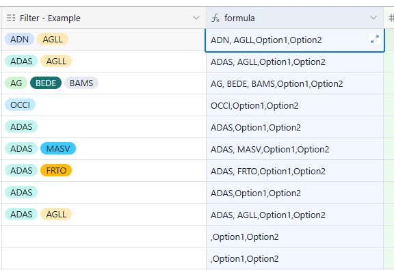

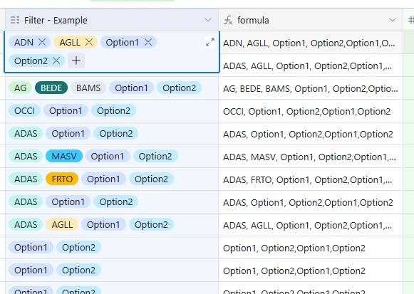

Why don't you just filter records you need, create _temp field with formula
{Filters (hidden}} & ',Option1,Option2'
select it, press ctrl+c
then select multiselect field and press ctrl+v
It's a minute action, and no scripts/automations needed.

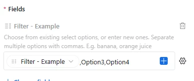

BTW, if you need to append instead of overwrite in automation,
instead of 'new value' , put inside 'old value', 'new value'
