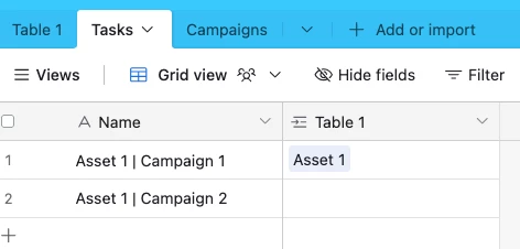

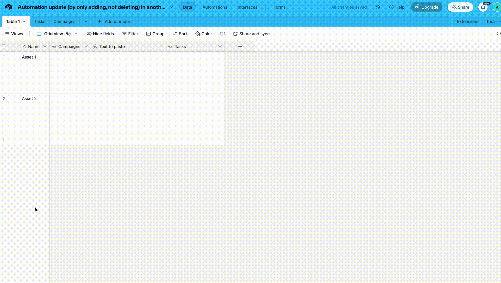

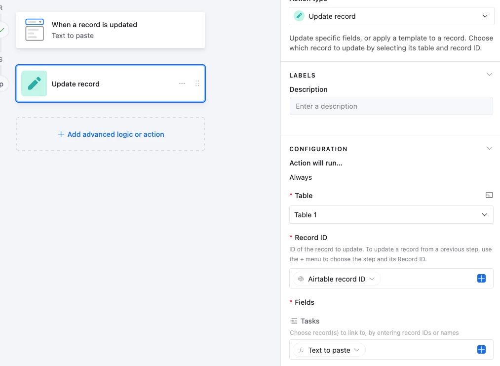

Hmm, how does this look?  And I’ve created it here for you to check out.
And the formula is:
AND({Name}, {Campaigns}),
{Name} & " | " &
SUBSTITUTE(
{Campaigns},
"," & {Name} & " | "
Note that you end up with a record in Tasks that isn’t linked to anything if you were to add and then unlink a campaign though:
