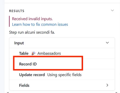

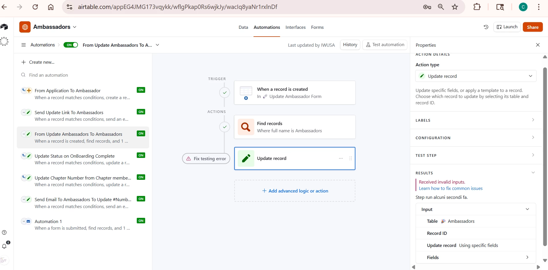

i’ve created an automation to update a record (eg. personal information) when a form is submitted to update.however for some applicants, is giving me this error. anyone that can help? thank you

What are you using as the Record ID input for your “update record” step?
Currently, your automation will only work if the “Find Records” action finds ONE matching record — but you will need to use the “List of Record ID’s” from the Find Records step as the Record ID to update.
(Note that your automation will not work if it finds zero records or more than one record. If it finds more than one record, you would need to setup a repeating action to “loop through” the records that were found in your “Find Records” action, and then you can update each found record.)

Thanks for the screenshot of the automation run!
From the screenshot, we can see that the ‘Record ID’ section is empty and so you’d want to start your troubleshooting there:

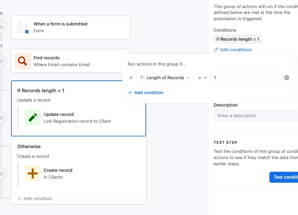

Assuming the error is because the ‘Find Record’ step can’t find an existing Ambassador record, you could try adding a conditional step into your automation so that it looks ike the following.  The idea is that if it manages to find an Ambassador record with the same name it’ll link it, and if not it’ll create a new record and link it
I’ve got it set up here if that’s helpful!
