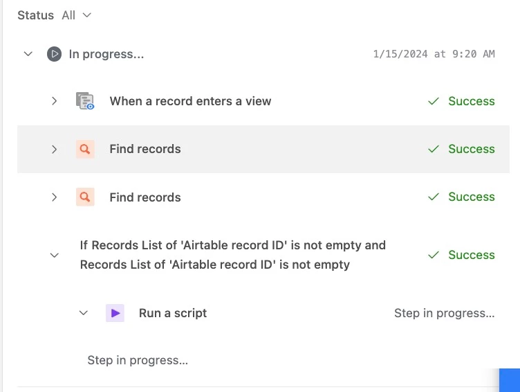

Running scripts in automation has noticeably slowed down on my end as well - 5-10 minutes for one simple script.
At first I thought it was not working at all... however, it seems it may be working, just VERY slowly.
Normally this works very quickly, within a few seconds.
Something seems to be glitching.. I've contacted support to let them know.

Upon further investigation, it looks like this isn't just an issue with the scripting feature... I adapted it to just use a normal conditional action (update record) and it's still going just as slowly (questionable if it will work at all)
I'm not working with tens of thousands of records here - in this case, a total of less than 1,000, with less than 100 being called to perform an action on
This is the first time I've experienced this... hopefully Airtable can fix!

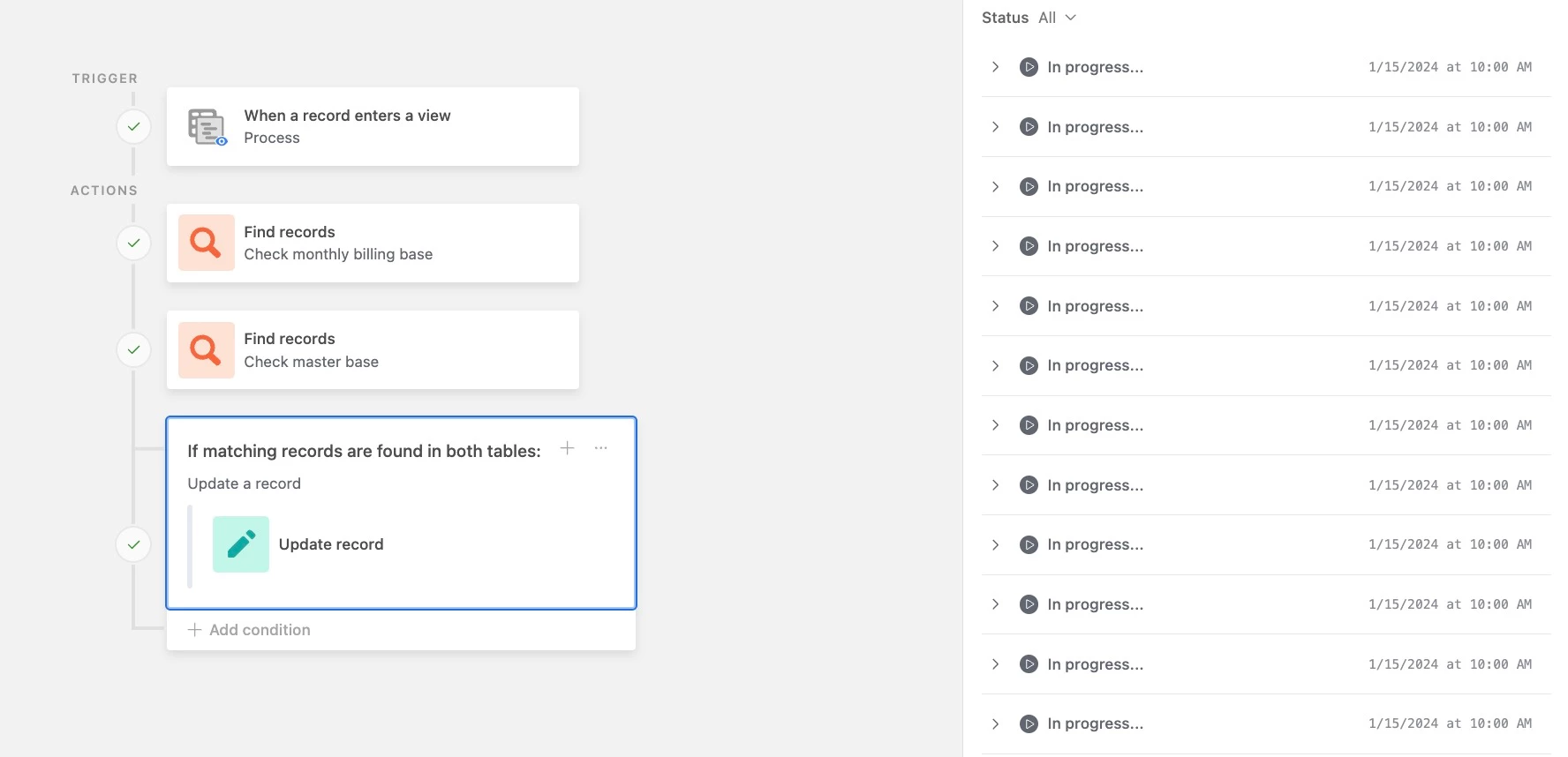

Ours are running exceptionally slow today as well. Simple automations such as one where we click a checkbox to update a record are taking minutes to execute (normally runs within 5-10s at most).
I've contacted support as well. Hopefully they can get this resolved quickly.

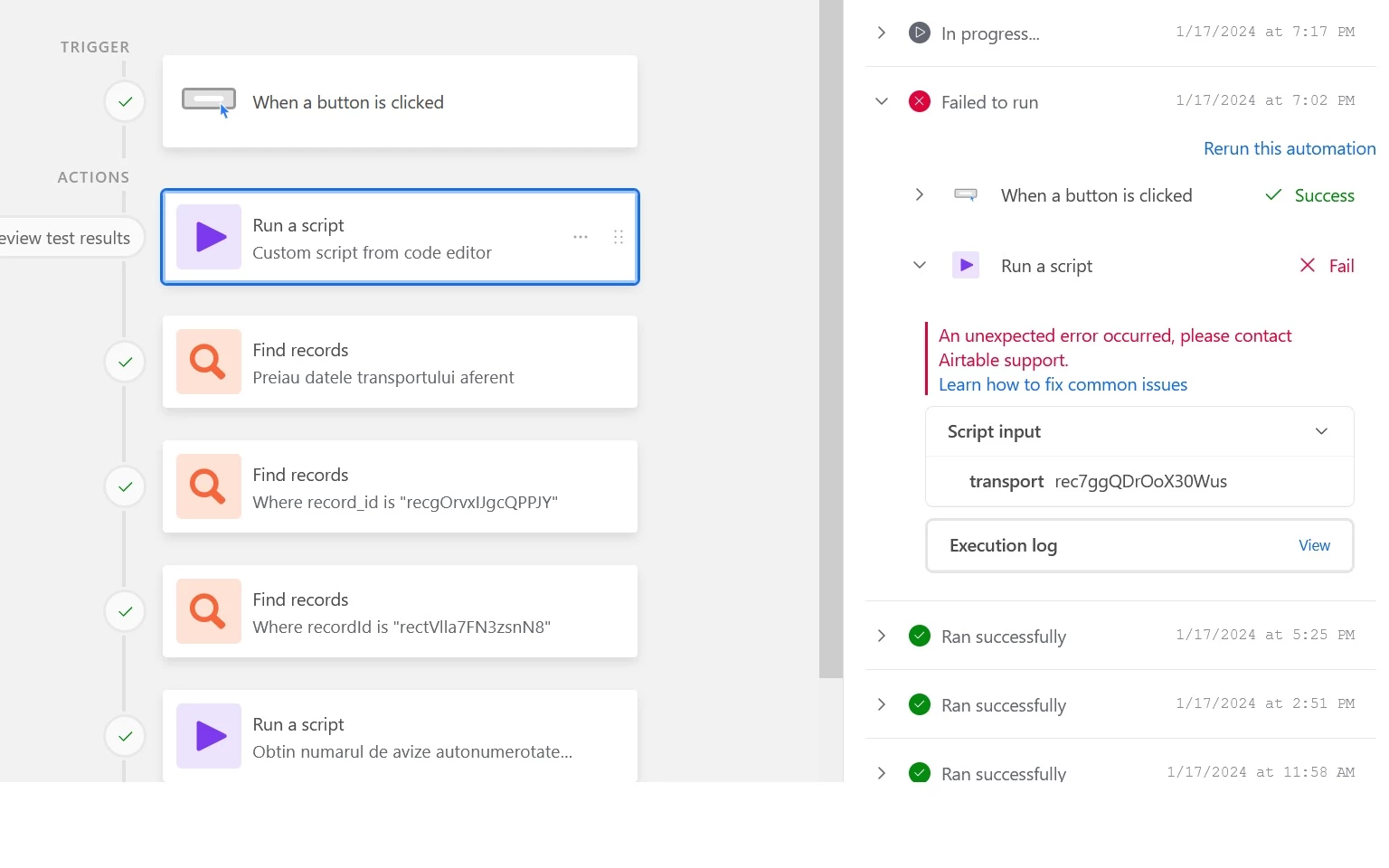

It looks like everyone involved here encountered the same issue over the past few days.
We got a mail from Airtable Support 2 days confirming that a fix was applied and everything is fine. We could confirm that indeed, until a few minutes ago, the automations' run time returned to normal.
But now everything moves slowly again. We are staring again at automations that are stuck over 5 minutes at each step!
What is happening?
  • January 17, 2024
At least now we receive an error message.
