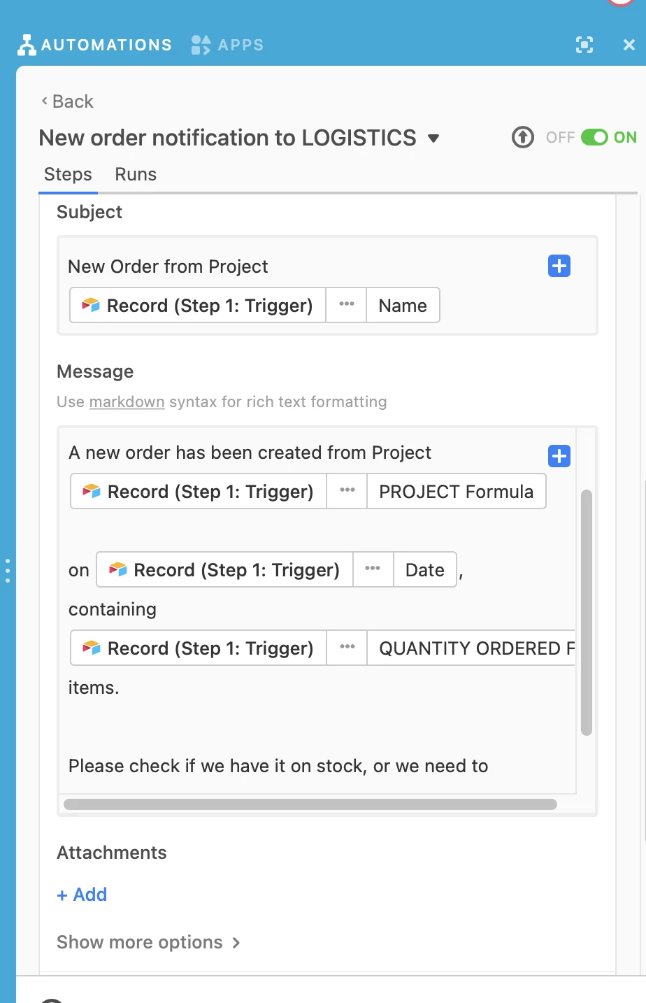

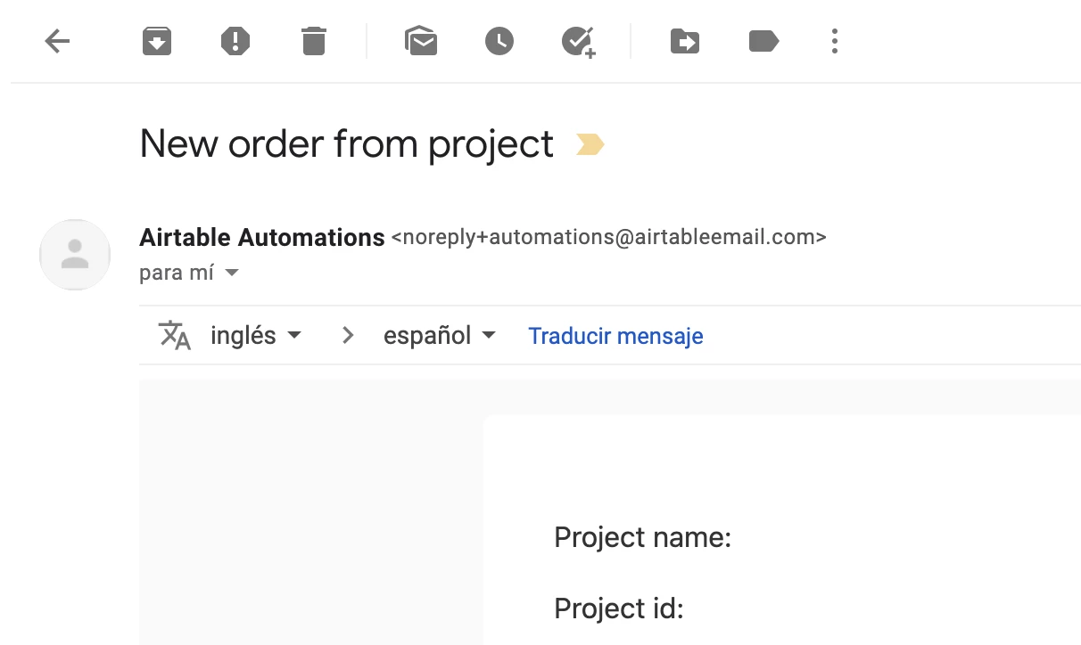

Hey AirTable Community!
I am having trouble with Automations. I have my trigger (When a new record is created).
When selecting my Action (send an email), I select all the fields I want to display on the email, but when I test it, it’s only pulling certain values, but most of them are left blank, even though the cell has actual information on it (linked from another record & tab)
Any solutions to solve this? Thanks!

Why don’t you post screenshots of your automation, so we can see how it is setup.
  • Jan 13, 2021 7:49 PM UTC
Here you go!
You guys are wonderful! I was pulling my hair out trying to understand why data was not inserting into a notification email action from a new record trigger. It work fine in testing but when I ran it by manually creating a new record (+ in table) the email had blank values.
Your comment that the trigger fired on the + when the record was blank was the answer. When I used a form to create the record, all the form values inserted into the email.
