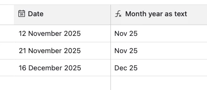

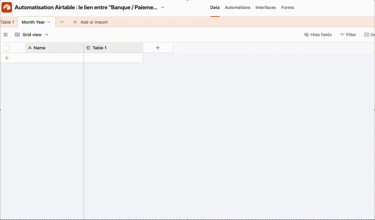

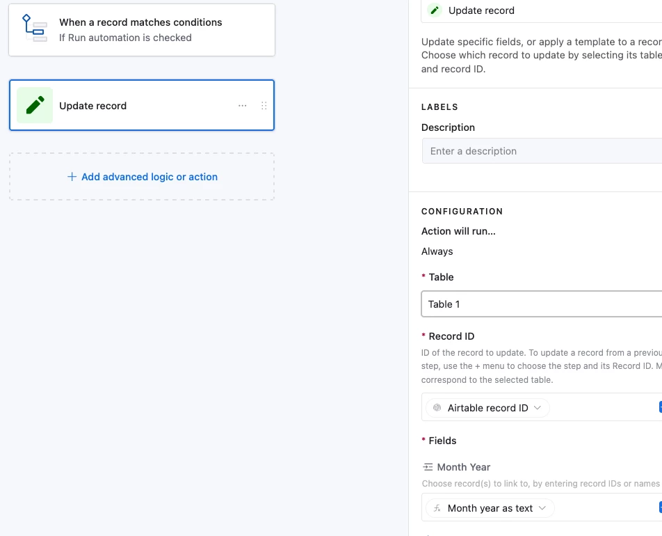

Ah I usually solve this by creating a formula field that’ll output the month year of the date field, like so:
And we can then use an automation to paste that into a linked field for us, and I’ve set it up here for you to check out

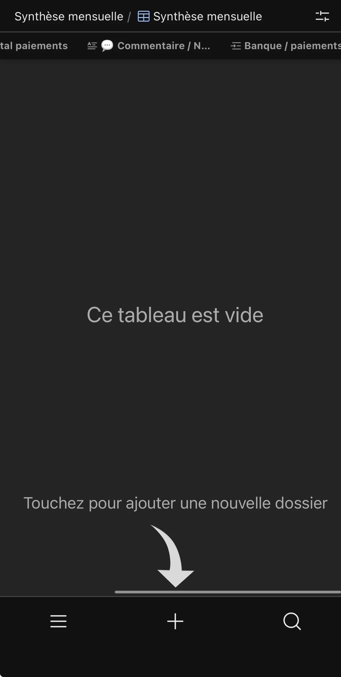

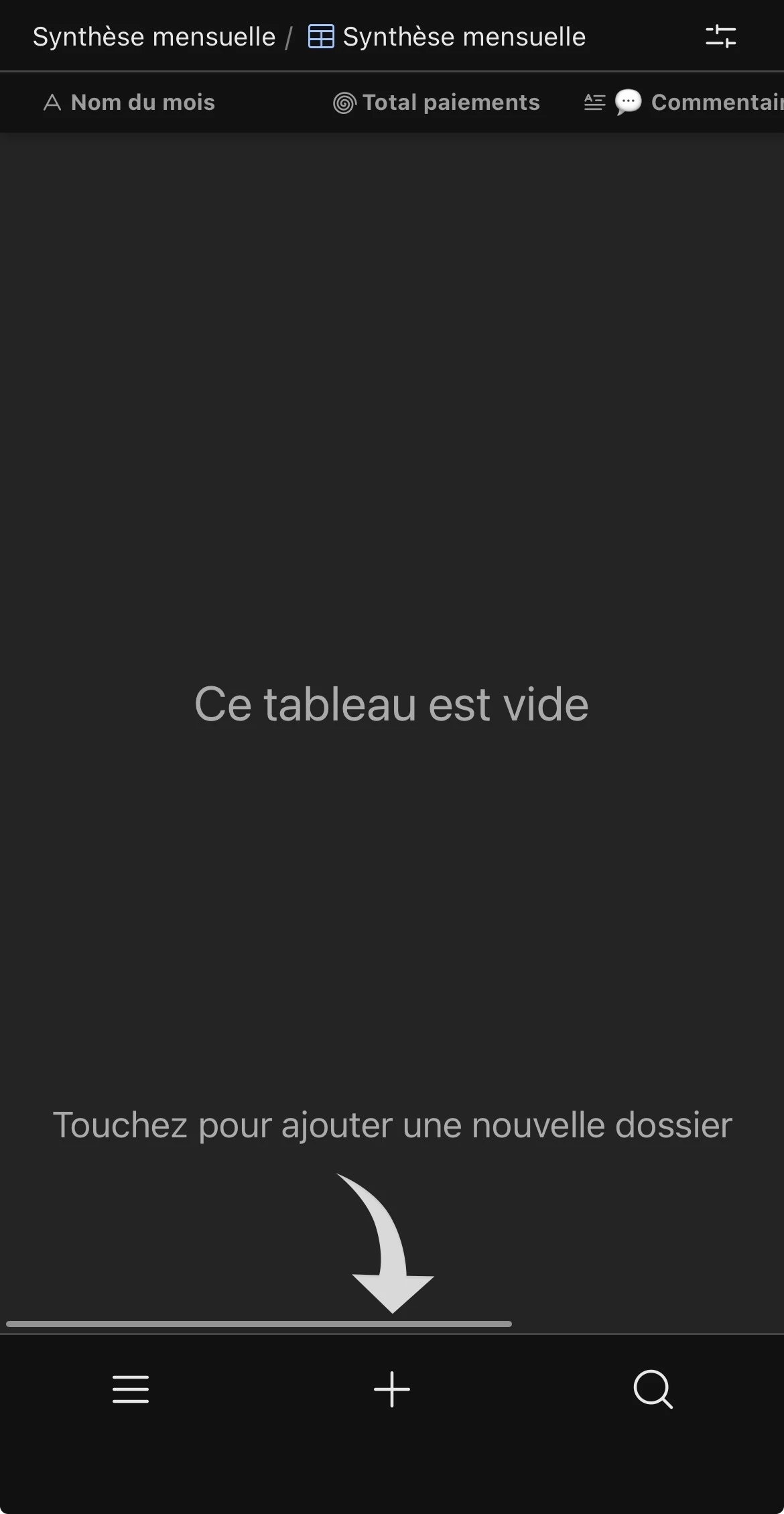

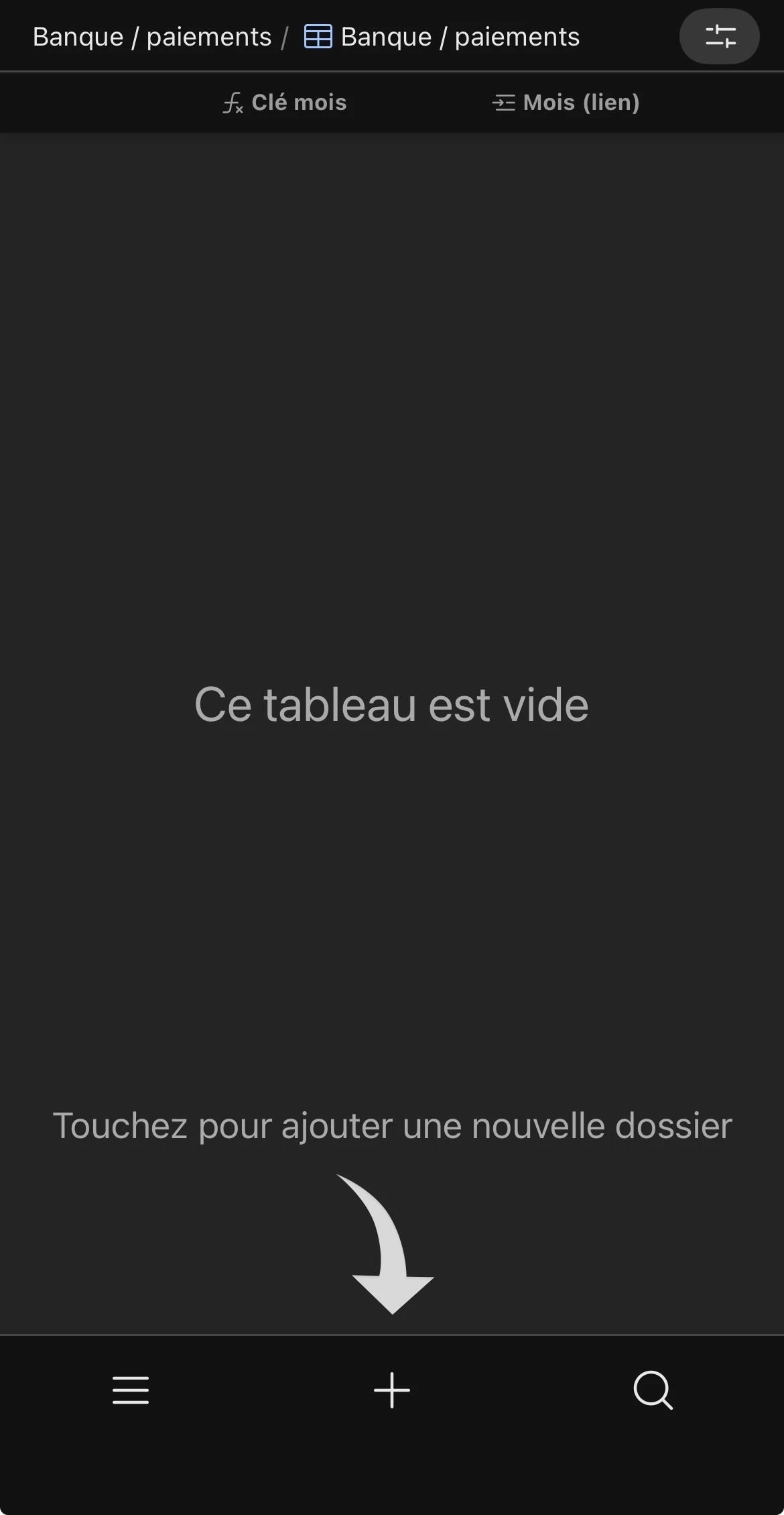

Bonjour, merci pour votre message. Oui, je vous envoie ma table banque de paiement et la table synthèse mensuelle où j’aimerais qui est le cumul là-bas, je vous envoie les deux photos. Pouvez-vous me dire quoi modifier svp
Et quel genre de configuration, je dois faire dans l’automatisation
Merci 🙏
You’d need to set up a new formula field with the following formula in the payments table:
DATETIME_FORMAT(Date, 'MMM YY')
And you’d create a new automation that would help you paste into the linked field.  How this triggers depends on how your data gets keyed in though, if it’s via a form you could use ‘On form submission’, if not, you might need to use a checkbox field to trigger the automation instead
Both of these things would need to be done via desktop I’m afraid.  If you could private message me an invite link I could set it up for you if you’d like!
