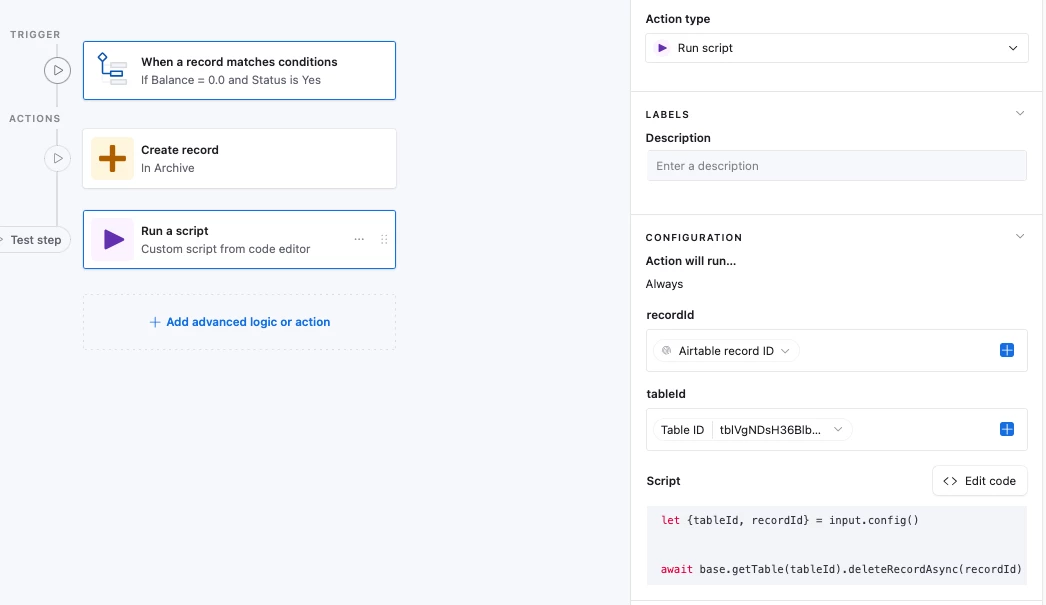

Does this look right?  If so I’ve set it up here for you to check out!
The automation triggers when Balance = 0 and Status = “Yes”, and it will then:
  1. Create a new record in the Archive table
  2. Delete the triggering record using a Run Script action
And you can duplicate the base into your own workspace so you can try it out!

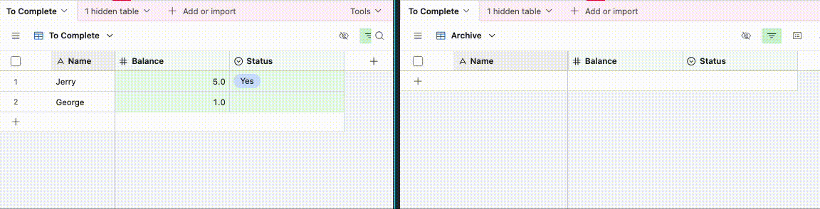

May I know why we want to move the record into another table?  Usually we would set up two Views in the ‘To Complete’ table:
  1. Active = Records where Balance != 0 and Status != Yes
  2. Archive = Records where Balance = 0 and Status = Yes

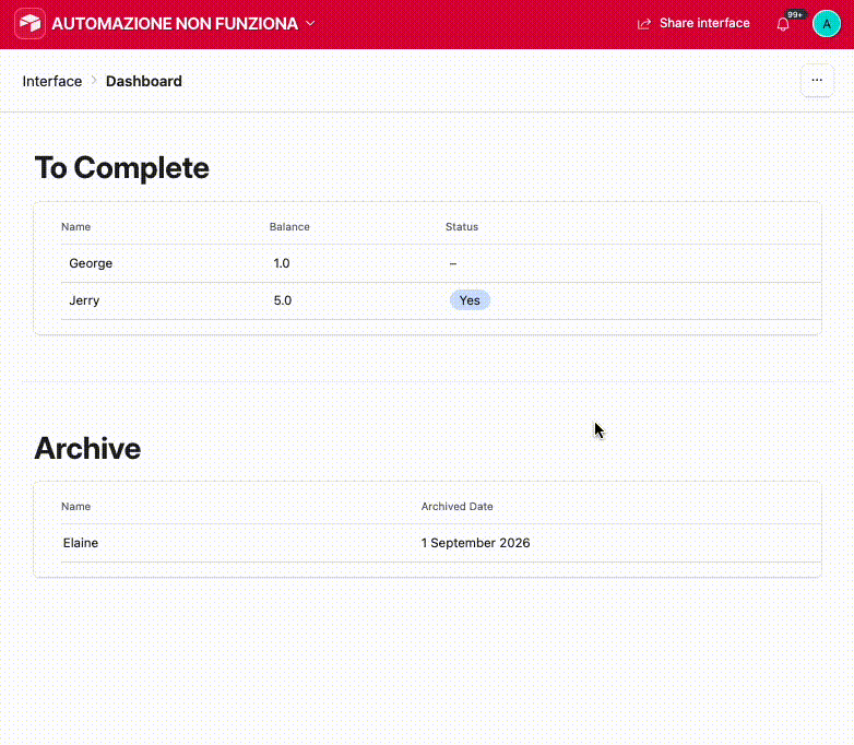

And this is how it might look:
I’m guessing that there’s some business logic that prevents us from doing this but wanted to provide an example just in case!
