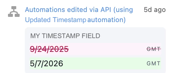

Be careful updating field types!
I have a few automations that watch a field for updates to set a field-last-updated timestamp. I discovered that if you change the field type of a watched field from multi-user to single-user, if there is data in the field, it will consider the field “updated” and trigger the automation.
This is not documented anywhere that I could find!  And it messed up my timestamps 😑
