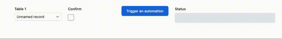

As a workaround, what if we put a checkbox field in front of the button as confirmation?  The automation would then check whether that checkbox was ticked before running, and I’ve set it up here for you to check out
You probably already know this, but for newer users it’s worth noting that buttons on the other Interface layouts have confirmation functionality available!
