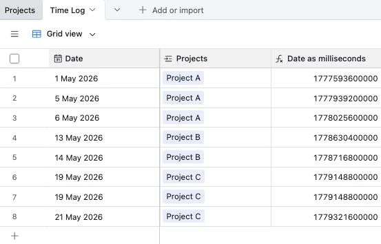

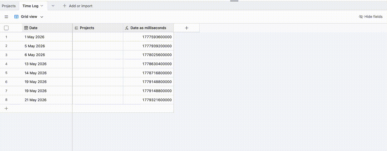

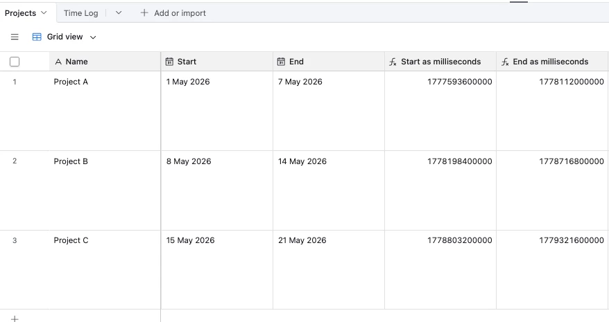

Ah to do this you can try creating helper fields that convert your Date fields into milliseconds using the following, which you can then set up in your Find Record action:
DATETIME_FORMAT(Start, 'x') + 0
I’ve set it up here for you to check out!

Your using a “Projects” table instead of an invoice table, but I guess it’s the same difference.
But in your formula: DATETIME_FORMAT(Start, 'x') + 0
What does + 0 do?
Ah the +0 converts it to a number so that the Find Record step allows us to use >=, <= etc.  If we don’t do that then it’s considered text, and the Find Record step will only allow us to use ‘contains’, ‘is’ etc
