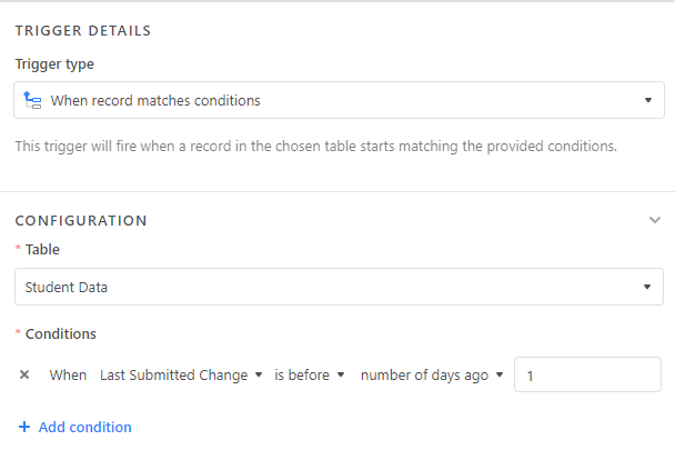

What is your automation trigger?
Also, note that your automation will only work for records that match your criteria from this point forward — it won’t go back in time and trigger records that matched your criteria in the past.

Here’s the trigger for the automation:

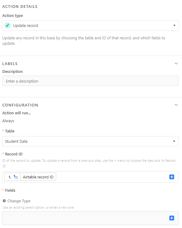

And the action details:
Let me know if you need anything else.

That should work, although I don’t think it will trigger until 48 hours have passed, because Airtable would consider a record to be “1 day ago” until it is “2 days ago”.
If that still doesn’t work — or if you want it to trigger exactly at 24 hours — you would need to create a formula field that calculates the difference in hours between “last submitted change” and NOW().
Then, you would trigger your automation when that formula field is greater than or equal to 24.
