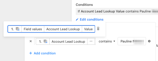

I’m using “contains” and the value. Here is a screenshot (if it uploads):
  • May 20, 2022
How strange, that is exactly what I’m doing.
