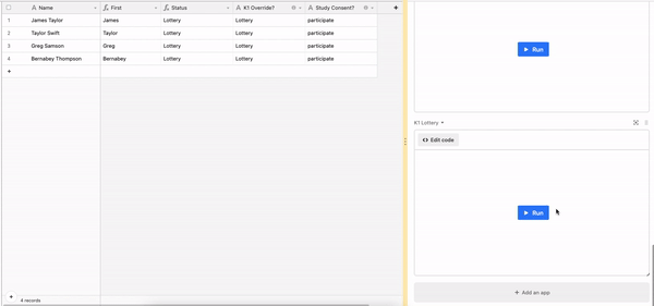

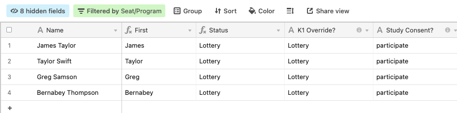

I’m having an issue with a conditional automation. Everything appears to be triggering and working correctly when things happen slowly. However, I made a script that is meant to set the conditions for another trigger. It seems like this is happening too quickly, and the automation is only triggering once instead of a few times.
The script affects the K1 Override? field. My organization has to run a random lottery for our kindergarten class, and that is what the script is doing. Whoever is selected, it writes in “Selected”,
otherwise “Not Selected”.The Status field has a formula that notices this and updates accordingly. The automation is triggered by the Status field.

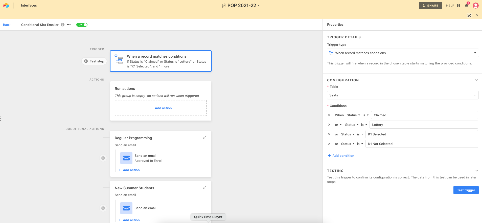

Here’s a screenshot of the trigger’s criteria:

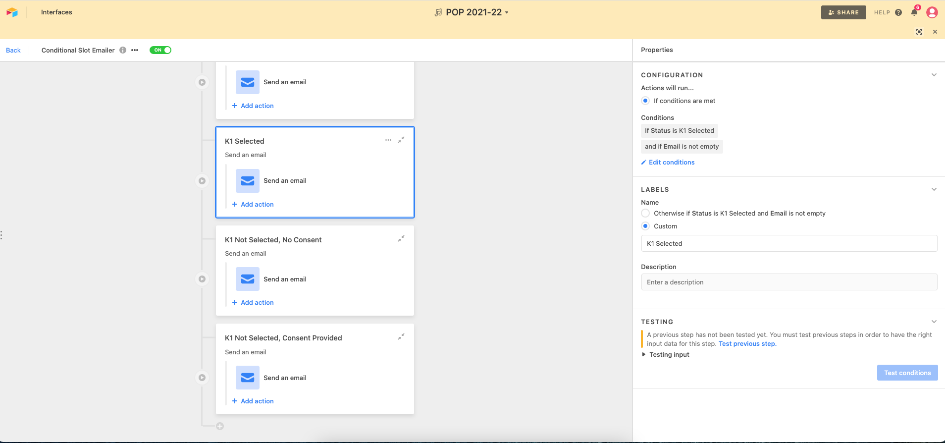

And one of the individual conditional actions:

Yes, AT automations have a poll time built in. Even when they say “instant”, I’ve found it can be up to 2 minutes. If you can script in a wait to prevent super-rapid changes, that would be your best bet to get this one working.
Hi Alyssa,
Thanks so much for your help! I tried this out, and was able to make a delay with the following:
function timeout(ms) {
  return new Promise(resolve => setTimeout(resolve, ms));
async function test(ms) {
    await timeout(ms);
await test(300);
This still didn’t seem to be working. So I tinkered with the trigger conditions. Instead of having multiple criteria (with OR), I tried just “when record is updated”, focusing on that field. By simplifying this, it seems like Airtable can more easily handle the rapid triggers, and it worked!
