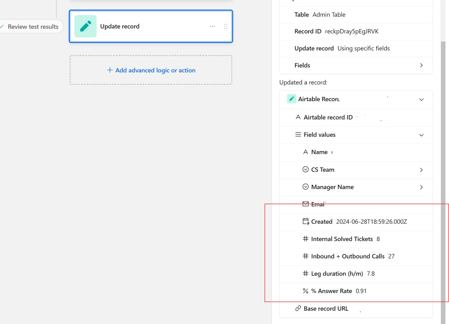

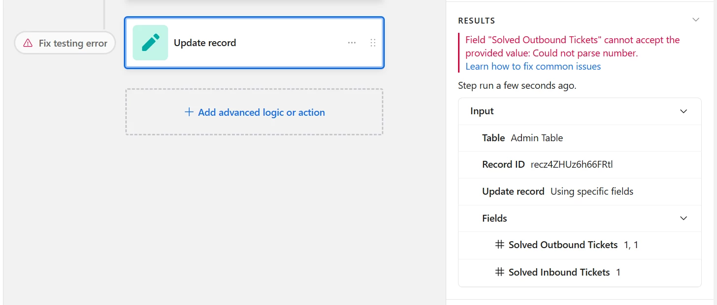

 Hi there,
I hope I'll find a smart head here that will help me tackle this issue.
I have two automation working on the same basis, we get an import from G Sheet, there are numbers there and we want to make the specific fields into a unified table, to create a 'clear' view with all crucial data in one place.
One automation takes the numbers and places them like it's asked, but the second one keeps on screaming at me "Field cannot accept the provided value: Could not parse number." This is really confusing as there are no operations run on both of them, just simple data, and one works, whereas the other is just being difficult.
Any idea what can be causing that? I thought that it just can't do numbers but one works so it's not that, both are done the same way and the issue still occurs.
Looks like you're trying to put the value "1, 1" into the number field and that's not recognized as a number.  Is that two "1" values?  Or is that supposed to be one "1.1" value?  Once you fix that it should be fine
