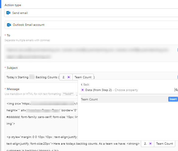

Awesome! This worked however when i try to reference it in the email automation i get the following error:
“This action does not have any output”. It wont let me insert it in the html.

You need to set the output to use it in an future automation step.

Can you explain how you got the output to work? I have 1000 records in a view and would like to get an email every time this view reaches this threshold.
I copied the script but can get the output to work? Any ideas.

Setup a view on your table and get that part setup so that it shows the data exactly the way you want it.
Create a trigger (everyday at this time do this).
Then run a script. Here is an example of mine.
const table = base.getTable(“Dynamic Builder Report”)
const view = table.getView(“Team - Backlog”)
const queryResult = await view.selectRecordsAsync({fields: })
const numRecordsInView = queryResult.records.length
console.log(numRecordsInView )
output.set(‘Team Count’, numRecordsInView);
Then on your email message, plug in that info.

Thank you so much! Worked like a charm. That was the missing piece.
