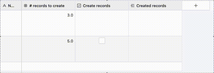

Hm, if you’re comfortable with using a script that would be much more straightforward.  I think I was optimizing for not using scripts back then heh
The idea would be to feed the number value into a script that’ll generate an array with that number of items, then use that array in a repeating group action
I’ve set it up here for you to check out

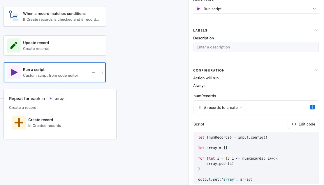

And here’s how the automation looks with the script:
let {numRecords} = input.config()
let array = []
for (let i = 1; i <= numRecords; i++){
array.push(i)
output.set('array', array)
let array = []
array.push(i)

I’m not but I’d like to be. So the scrip creates an empty array with the number of records you specified in the field, so that the loop then has an array as a base to iterate through x number of times?
Does this mean the script is a generic ‘create a blank array of x records’ that can be used in different scenarios?
Much appreciated, wanting to learn as much as just using this!
Ah, specifically, it’ll create an array with [1, 2, 3, 4, etc] until it hits the number we want, does that make sense?
Yeap to this too!
