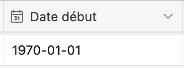

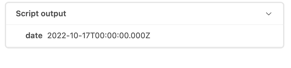

I have tried to achieve this using a script in the automation but it doesn't work. Somehow the output in the script testing is correct, but the value displayed in the created records are wrong..
Any idea?
Many thanks
Hmm, besides double checking that the date value you're putting into the field is in the ISO 8601 format I'm not too sure either.  As a workaround, perhaps you could create 5 formula fields with "DATEADD()" instead, and use those values within the automation?
