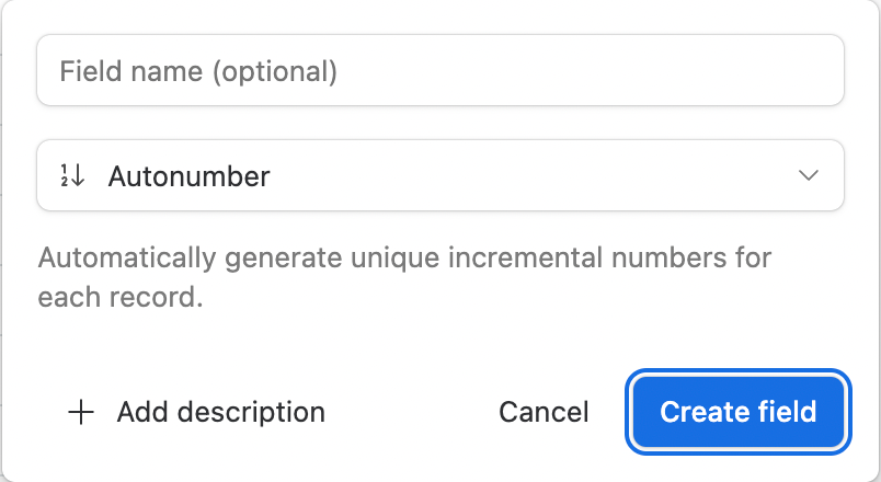

Hi Sehenley,
There's a field type called Autonumber which may work for you. You can then set this as your primary field.
It's worth noting though that if you create a record and delete it, it will still be counted and your next record will skip that number.
There will be a way to do it with some extra fields and an automation but I'm not sure off the top of my head.
