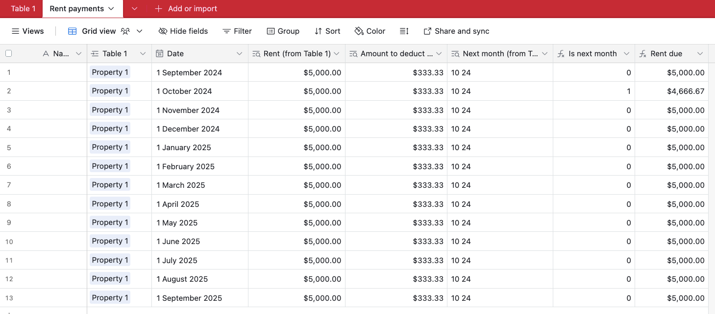

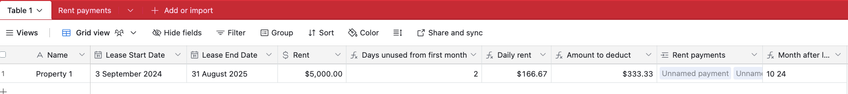

Hmm, does this look right?  I'm assuming that daily rent is calculated with the assumption of 30 days a month
The only tricky bit would be creating one record per month between the lease start and end date, which I think you'd need to use a script + automation for
And I've set it up for you here so that you can see how I did it!
