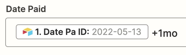

Hi there - I’m a bit stuck if I can do this with Airtable and definitely can’t get it to work with Zapier, so wondering if you can give some insight…
Here’s what I’d like to have happen:
  • Member joins program and chooses a 6-month payment plan
  • Their 1st payment gets imported into AirTable
  • 5 automatic records for their subsequent monthly payments get created so I can track projected revenue
I thought I could do this in Zapier by using the date modifier (of adding +1mo to the current payment date), and although it imports, the date is left blank.
Is this a formatting issue? Any other ways to do this with Zapier?

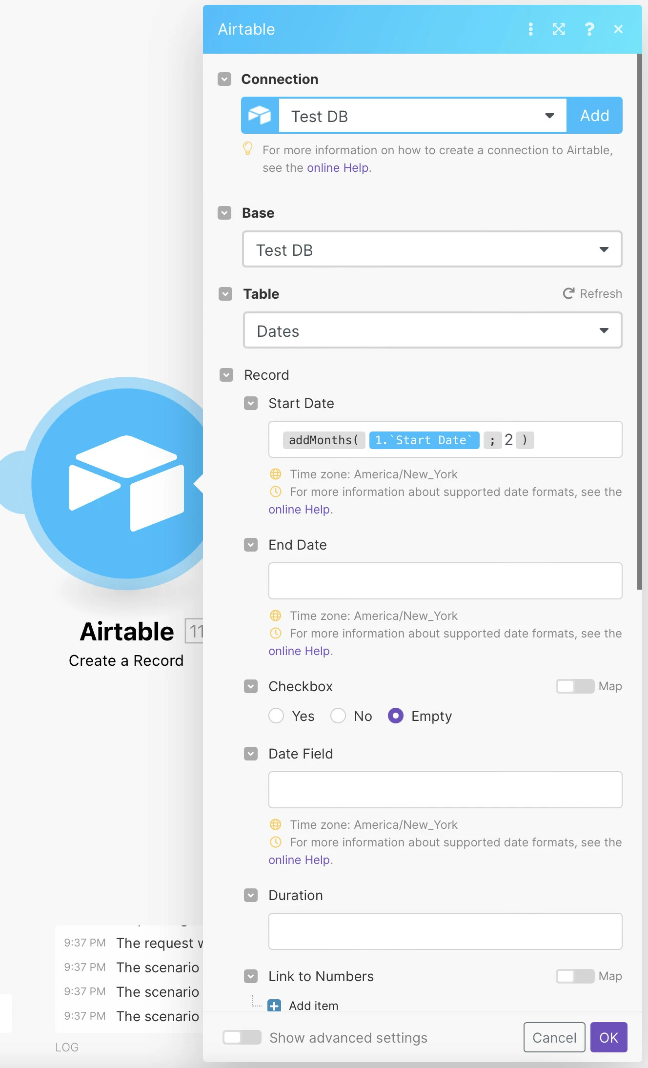

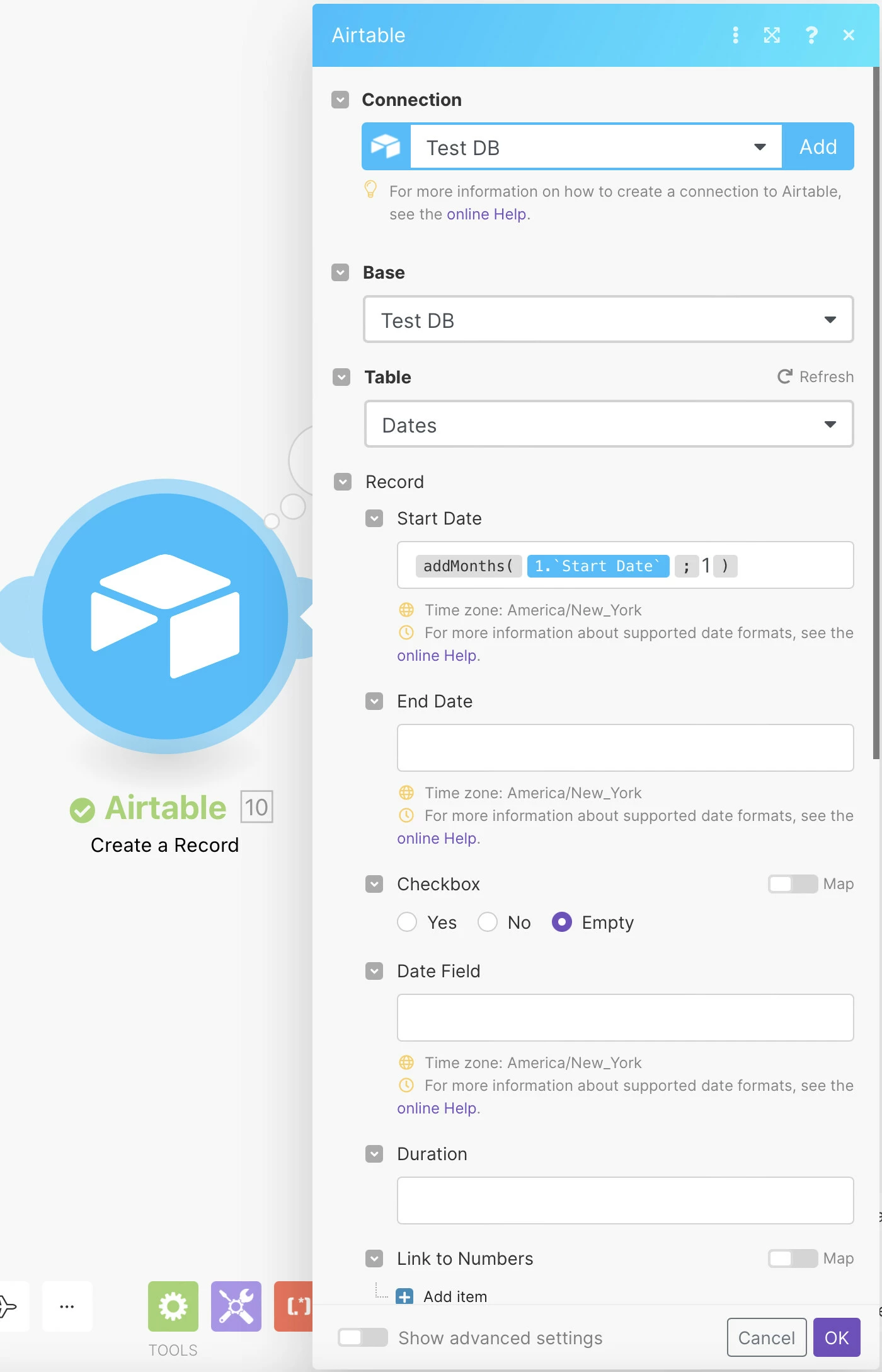

I’m sure you can do it with Zapier, but my guess is that “+1mo” is not a valid way to do date math in Zapier.
I don’t use Zapier much so I can’t really guide you there without spending time researching it, but I know that you would do this very simply in Make.com by using their “addMonths” feature.
In the first screenshot below, I’m adding 1 month to the date field that I selected. And in the second screenshot below, I’m adding 2 months to the date field that I selected.
You could also do this in Airtable using Airtable’s native automations, but since Airtable’s automations can’t do math at all, you would need to first create 5 different formula fields (each one representing a different date in the future), and then you would hide those formula fields on your grid, but you would refer to those hidden formula fields when creating your new records.

  • June 14, 2022

+1mo came straight from Zapier documentation, but it does not import properly to Airtable. Thanks for the tip on the other tool - hoping to keep the ones I have without adding another.
You might want to let the Zapier people know about this. It might be a problem with their Airtable modules that they need to address.
