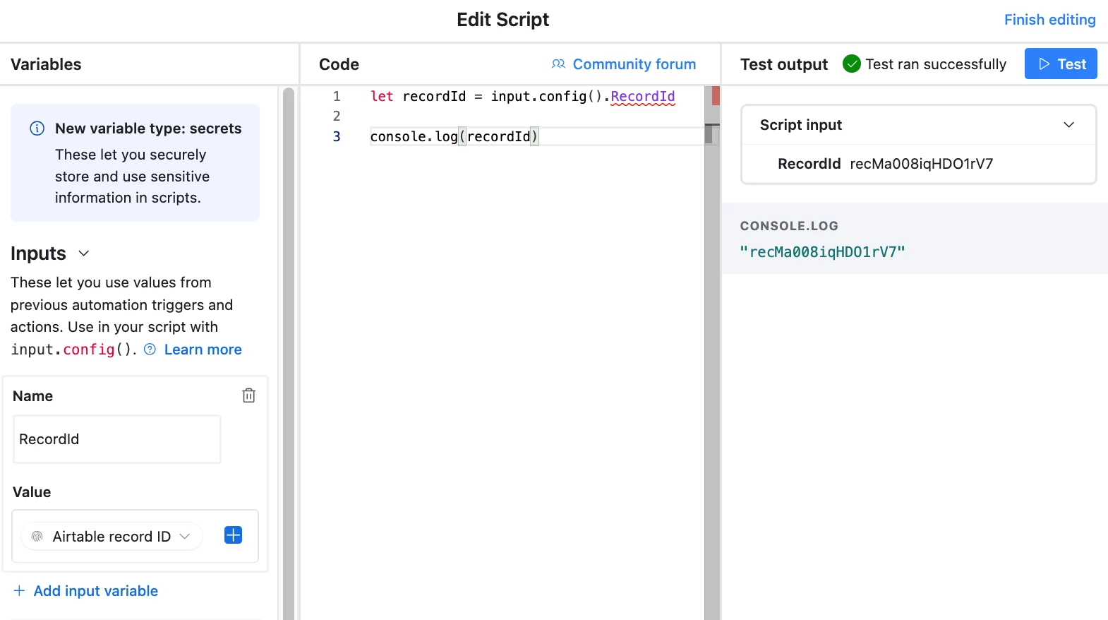

Difficulty getting run script in automations to accept Input recordId that has been set up correctly by previous step, e.g after 'when record enters a view'

Margaret_Picker
Forum|alt.badge.img+13
Despite log showing execution:
I still get error :
I believe the script to be OK,  “let recordId = input.recordId;”
Does anyone have any suggestions?

  • Aug 6, 2026 5:37 PM UTC
The value is read through input.config(), rather than directly from input. Try:
const { recordId } = input.config();
console.log(recordId);
In the Run a script action, add an input variable named recordId, then map it to the Record ID token from the trigger step. For When record enters a view, choose that trigger's Airtable record ID token. The variable name must match exactly, including case.
Yeap, echoing TinyOpsStudio.  You can also try this:
let recordId = input.config().RecordId
