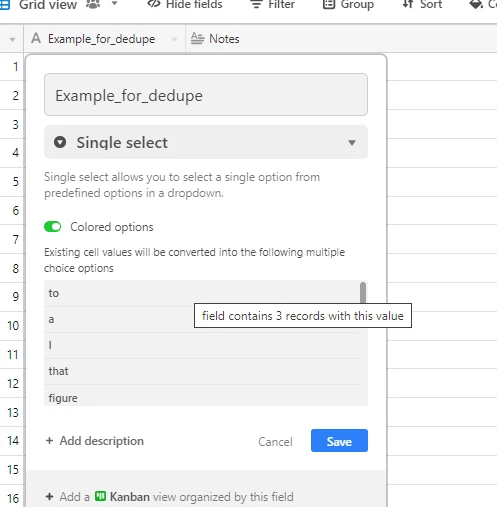

The “simpliest” way, just to take a look at number sorted from highest number - is to start customize field and choose single select, but don’t press Save.
