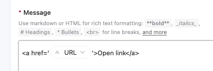

I have an Automation that sends an email when conditions are met that includes Update Record link for Fillout. However the link is emailed as a text field - e.g.  https://forms.fillout.com/t/zzzz?id=xxxx
How do I modify so it sends as a clickable link.
I have tried  "<a href='" & {Your Formula URL} & "'>Open link</a>"  and it did not work.
Try setting it like this:

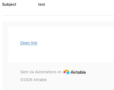

This is how it looks as an email:
I’ve set it up here for you to check out
  • Feb 6, 2026 10:40 PM UTC
That Works….
Thanks
