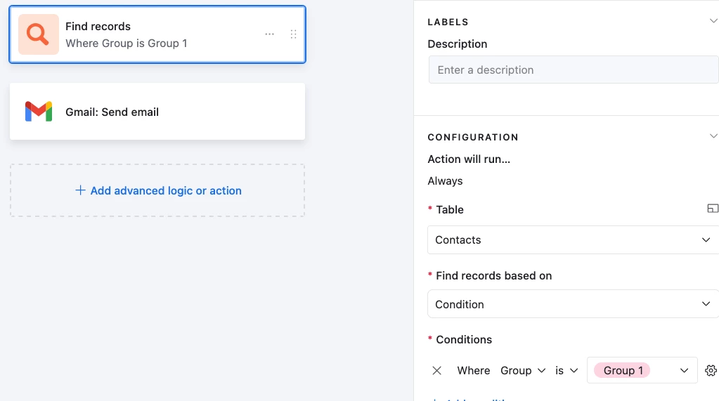

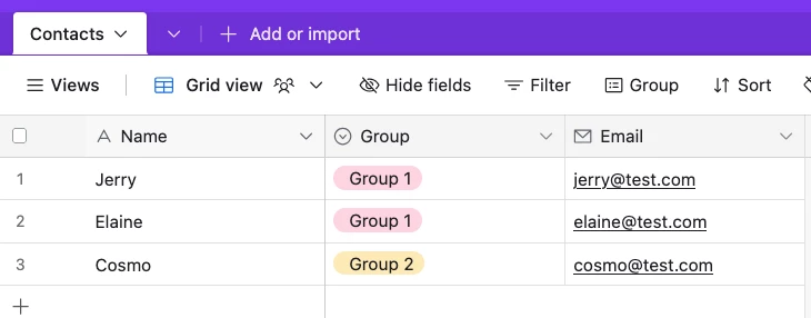

Assuming your data looks like this:
Then you'd add a Find Record step to your automation to look for all the relevant records, and within my context it's looking for everyone in Group 1

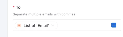

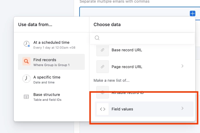

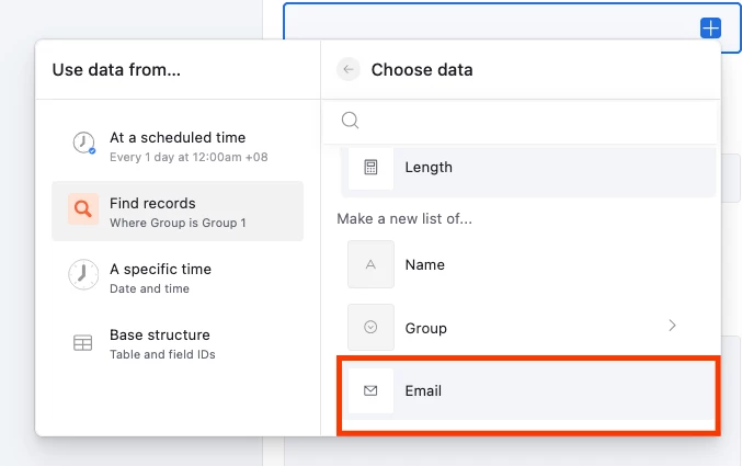

You'd then insert the Email values from all the found records like so:
And you'd end up with this:
And I've set it up for you here!
  • January 31, 2025
Thank you, appreciate the time you took to respond! The Find Record tool was what I was missing to find the proper emails - then I set up a repeating group.

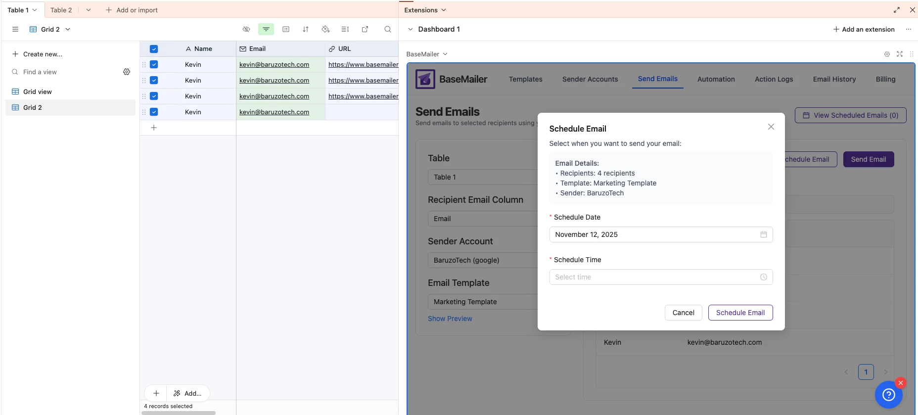

  • November 12, 2025
You can use the BaseMailer extension to design the email templates using drag & drop template builder, select the records or view and schedule the email to send at specific time.
https://airtable.com/marketplace/blkELmD2dcBpsQZZW/basemailer
Schedule emails with BaseMailer in airtable
