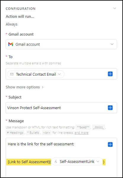

Thanks, Scott!
The markdown workaround worked.  Here's what my automation looks like now:
I added the bits that are highlighted.  Worked like a champ!
Thanks so much for the quick response!
