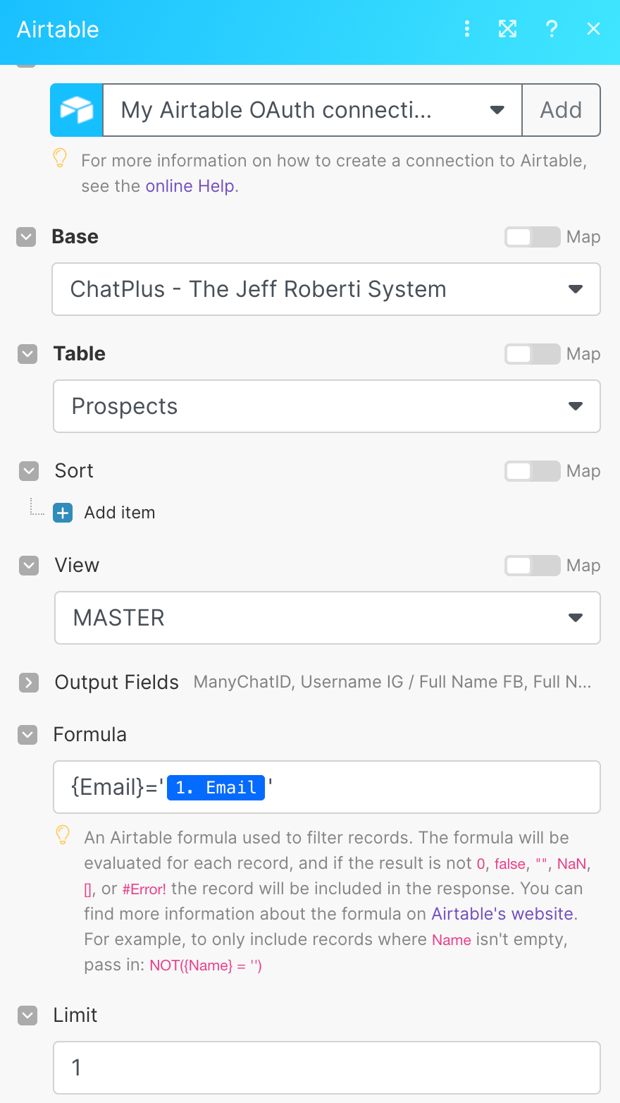

Hey all,
I am trying to use the 'search records' module in make to search for a record in Airtable based on an email field (see below).
The error I am getting is: [422] Invalid request: parameter validation failed. Check your request data.
I feel like I've tried every iteration of structuring the formula (with and without ' ' or " ") with no luck.
  • July 16, 2023
I'm getting the same error while performing the same task (search for a record using Make.com).  Even without a formula I'm getting the error.
  • July 16, 2023
I just solved my issue by unchecking the "Select all" output fields, and checking only one output field; then the search worked.  Perhaps there is a limit on the number of output fields that can be called.
  • December 19, 2023
This worked for me. thanks
  • December 19, 2023
When using Make to search Airtable records, you should typically leave “View” and “Output Fields” empty, so that it returns all fields and searches through all records. Those are optional fields which are used to restrict output.
