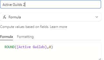

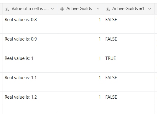

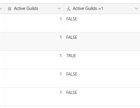

To narrow a scope of possible reasons, try to add another formula field with {Active Guilds}=1 and check whether it's true
in my example, reason is a lack of decimal places.
Pascal_Gallais-
Hello,
If, as Alexey suggests, your formula "Active Guilds" does not return an integer value (even if formated with no decimals), then you could define a formula on top of this one to round the value and get an interger:
You cant then use this rounded value in your automation.

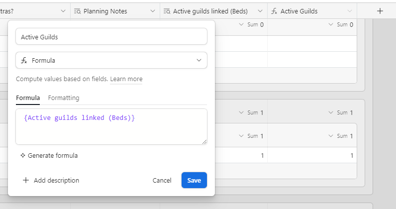

I may be misunderstanding, because this field can only be an integer.
The set up:
Active Guilds Lookup field (this looks up a "count" field in another base)
Active Guilds field (this is the formula field - I created this because automations didn't have a way to interpret the lookup field as a number)
So, because this formula references a lookup which references a count field, the result can only be an integer.
When i check whether active guilds = 1 with another formula field, it is returned as "true"

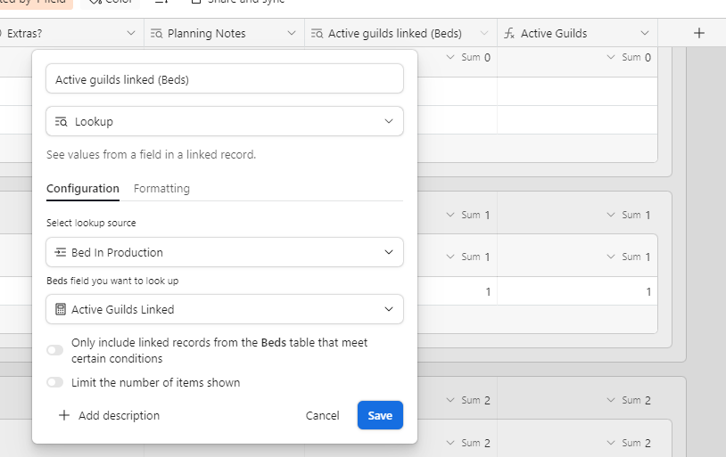

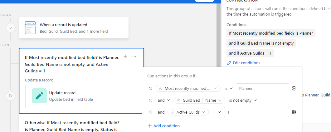

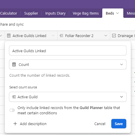

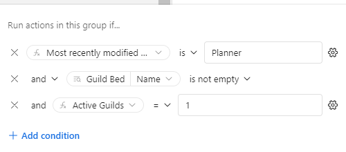

Sure!
This is the base being referenced by the lookup field. It's a count field.
This is the base it runs in. Here's the lookup and the formula field that references the lookup.
These are the conditions on the automation
Pascal_Gallais-
Thanks,
I understand better and i did reproduce the issue.
What you can try is to modify your field "Active guilds linked (beds)". Instead of a lookup, do a rollup with the default formula "SUM(values)".
You should then be able to use it directly in the automation conditional statement.
Regards,
Pascal
