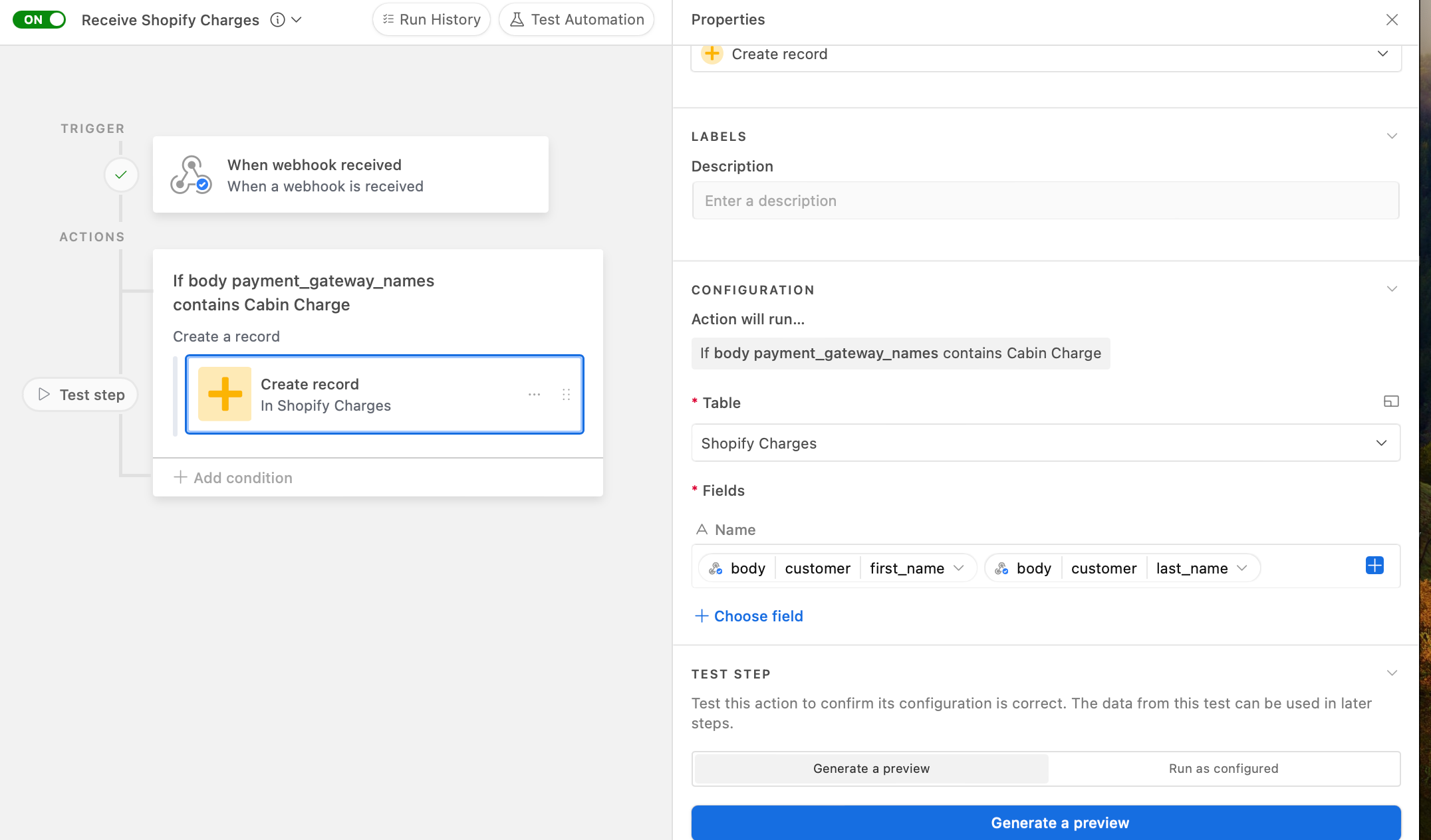

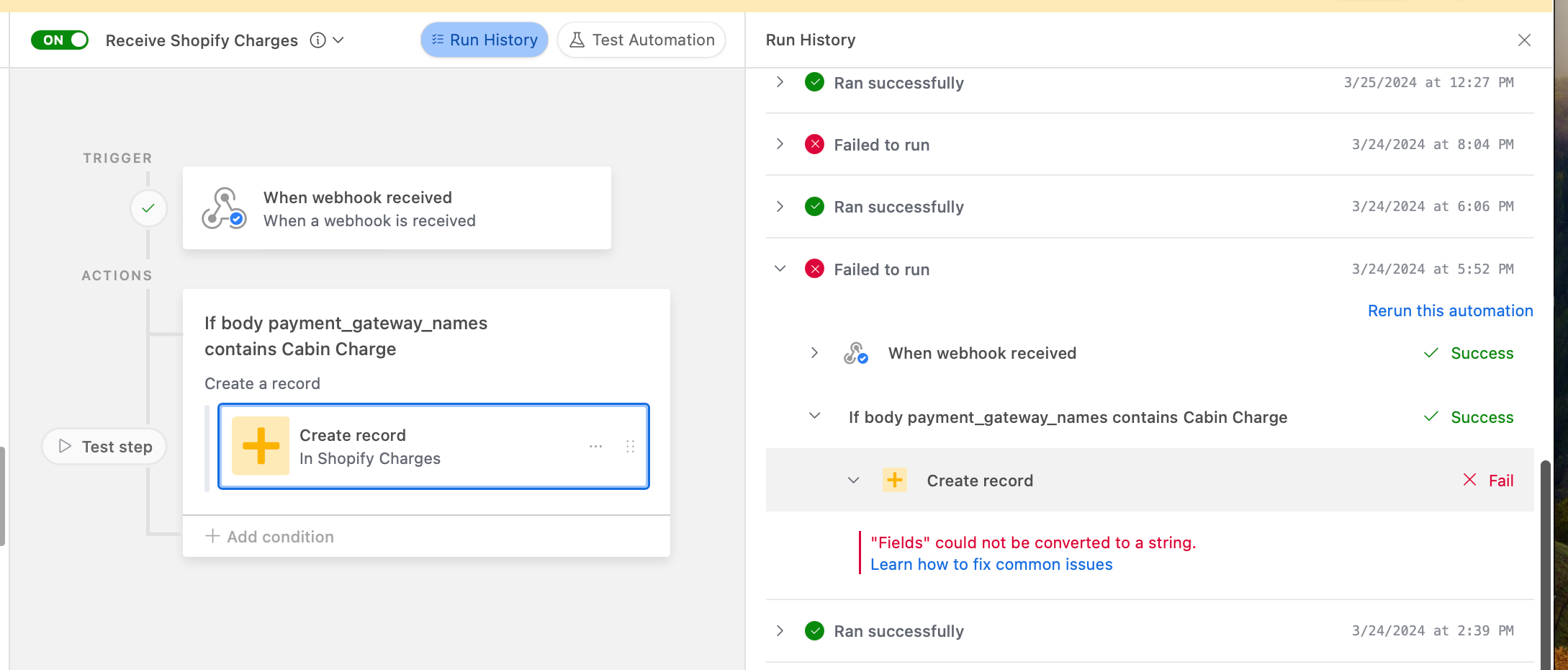

Has anyone found a solution to this? An automation of mine that usually runs fine, started throwing this error and failing sporadically. It's for a webhook automation that brings in orders from Shopify. In my attempt to isolate the issue, I've deleted every field from my "Create Record" action, except for a name (single line text) field where I attempt to enter the Customer First & Last name, but it still fails. 🤔 🤔 There are no roll-ups or formula fields on the table where I'm trying to create the records.
No actual fix, but for your webhook, if you make a copy of the automation and update the webhook URL in Shopify, you may have similar luck as did.
I ran into the same issue with an automation (triggered by a condition) that has been working for some time. I made a copy of the automation to test and left the old one on... I started manually triggering the new automation by emptying the values in the cells that trigger it and then pasting them back in. It triggered both automations! so I have a little cleanup to do, but the old one seems to be working again.
