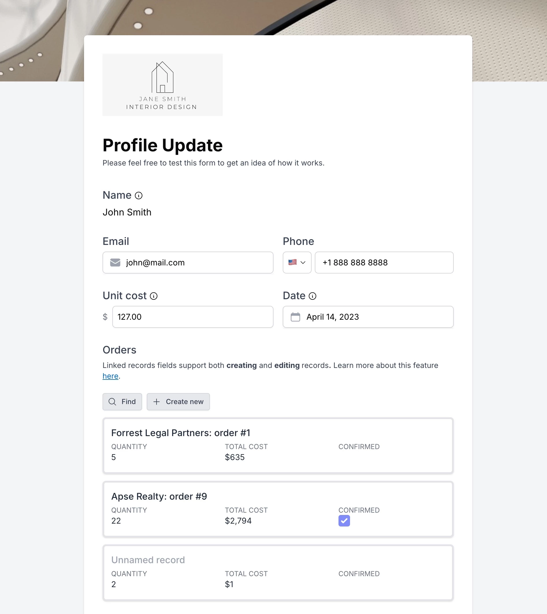

Try using Fillout Forms to create linked records for you
https://www.fillout.com/help/create-new-linked-records#

Hey there, seems like you could do with some linked record fields, as Hairtable already suggested above. You could add a user with a form and then have the user link their company and project as linked record fields. That way you'd have all the data in the correct tables right away and it would all be linked together properly. Our miniExtensions Form offers this functionality out of the box with minimal configuration required. You can try it out now with a free account to see if it might fit your use case!
Once the data is in Airtable, you could also use our portal extension to then manage the data with your team, without the need for everybody to have an Airtable account!
