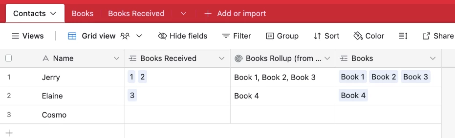

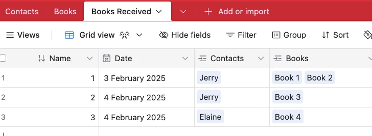

Hmm could you provide some screenshots of your table setup?  I tried to imagine what you were trying to do so I could help figure out the automation and came up with the following, but I'm not sure if it's right:
Link to base
