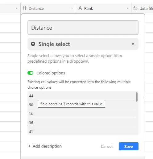

it depends on what kind of duplicate search you need
quick check for duplicates
duplicates here:
change to Single select
sorted list of duplicates will be at the top
don’t press Save, press Cancel
Primary field can’t be single select, so one additional step needed

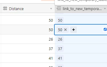

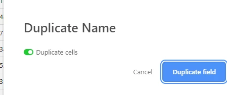

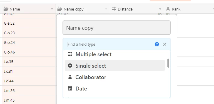

If you have large table and want to mark duplicates
Select whole column, ctrl+c/ctrl+V (to new column)
If you want to prevent entering existing value by automation - it depends on what kind of “prevention” do you need. Inform by mail alert, delete/rename… in forms, the only way to “validate” - is to create conditional required field, make it single select, put warning in description and delete all choices. Thus, user can’t submit until it disappears…
