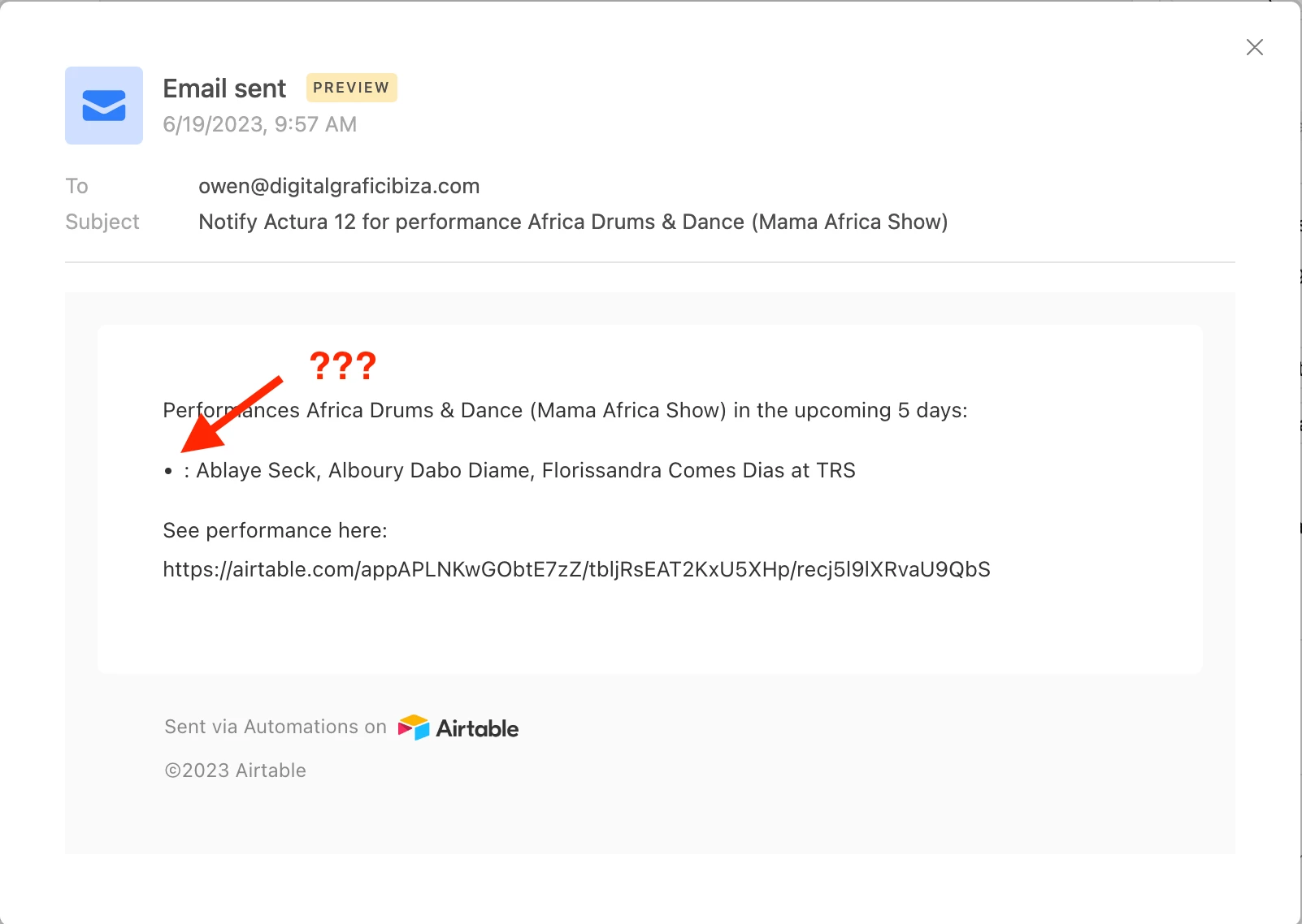

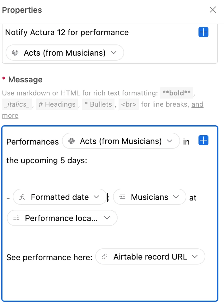

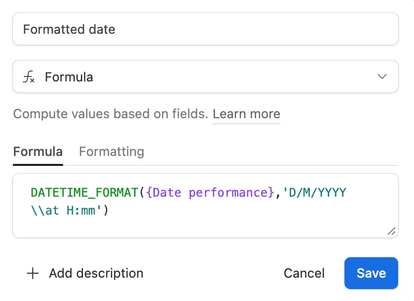

I had the same issue so I tried the solution in this thread, however when I put the field that has the `DATETIME_FORMAT` function in the email action and generate a preview of the email the field doesn't show at all inside the email (see screenshots).
What am I missing here?
In order to get the emailed date in the subject line, I created a column just to show today's date.
DATETIME_FORMAT(TODAY(),'M/D/YYYY')
Now I can reference it in my email trigger and it will show correctly.

It turns out I had to update both the Trigger and Action Test Steps to see the correctly formatted email in the preview.  I was only updating the Action Test Step.

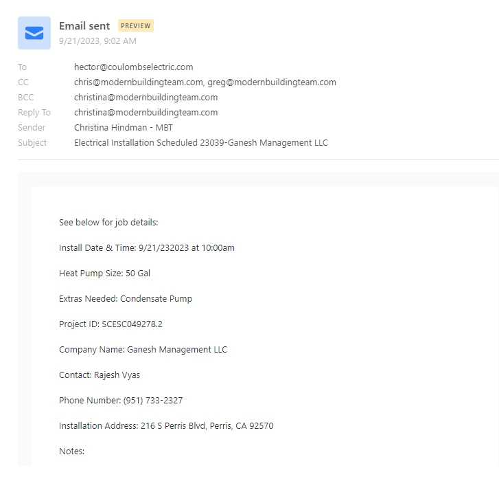

I did this and it fixed my time formatting in my email automation but it messed up my year. How do I fix this?
See attached, its displaying 9/21/232023
