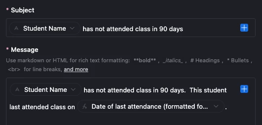

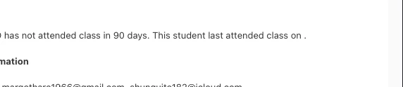

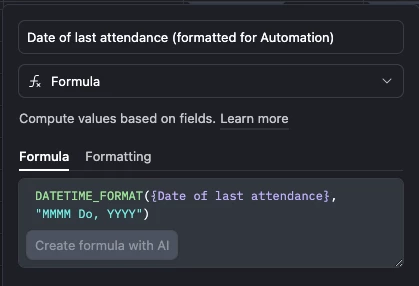

I’m building an automation that reports a date, and I created a field that uses DATETIME formula so that the date shows up in a readable format, as suggested on other threads linked below (thanks ​@ScottWorld and ​@John_Reid !) The problem is that the DATETIME formula output is not showing up in the email automation. Screenshots below--
The formula field that uses DATETIME formula to format the date in a readable format
The email automation set up
Email automation output

Are you just testing your automation? If so, you need to test all the previous steps of the automation in order to push actual data into the subsequent steps below.
  • Oct 7, 2026 10:03 PM UTC
  • Oct 7, 2026 10:11 PM UTC
Yes, that worked, thank you!
