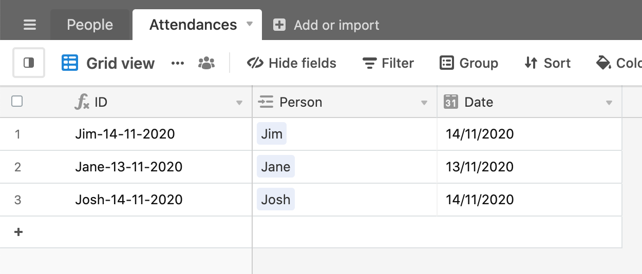

Hi @Luis_Pedro_Cuellar - yes you can do this. If you attendance table is something like this:

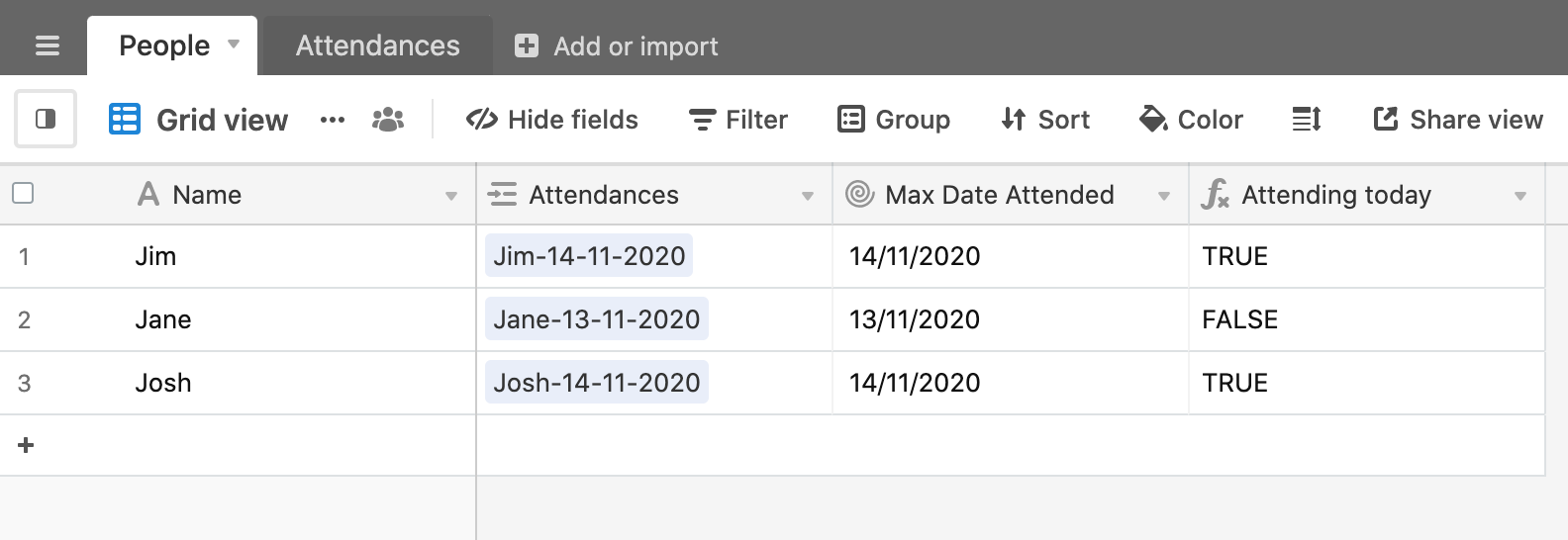

Then you can get the max date from this table in the “people” table using a rollup:
Then add a formula field to show TRUE or FALSE if the max date for each employee equals “today”
IF({Max Date Attended} = TODAY(), 'TRUE', 'FALSE')
You don’t need to filter the attendances table to achieve this - the rollup is doing the work for you.
