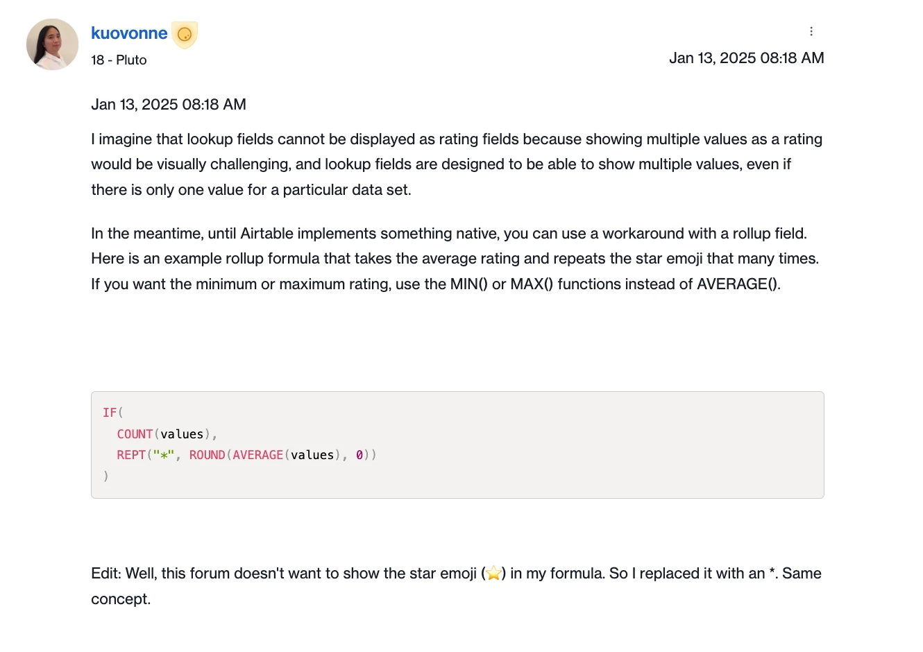

Also, below please find a screenshot of @kuovonne's amazing workarond!

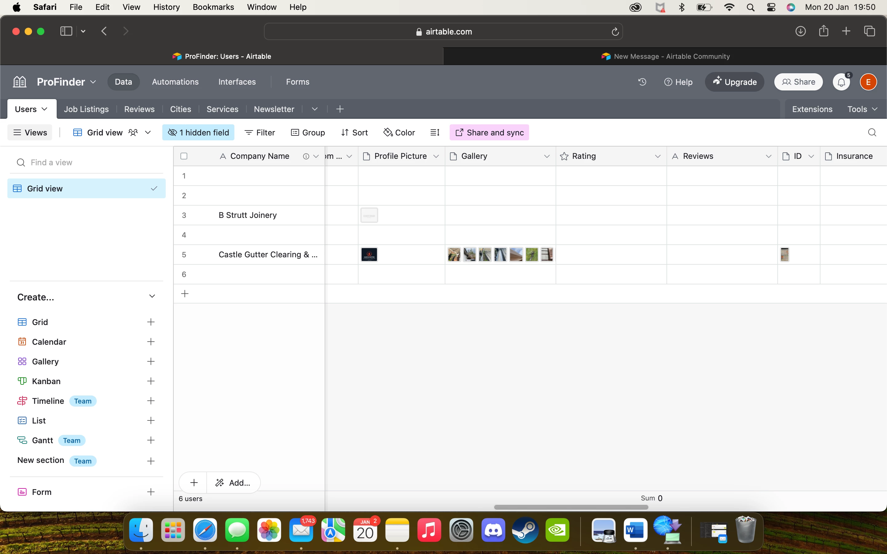

Hi Mike,
Perhaps I haven't got the tables connected properly. I find getting the fields to connect correctly very confusing. I need the average rating field to show in the users table. Thanks for your help 🙂

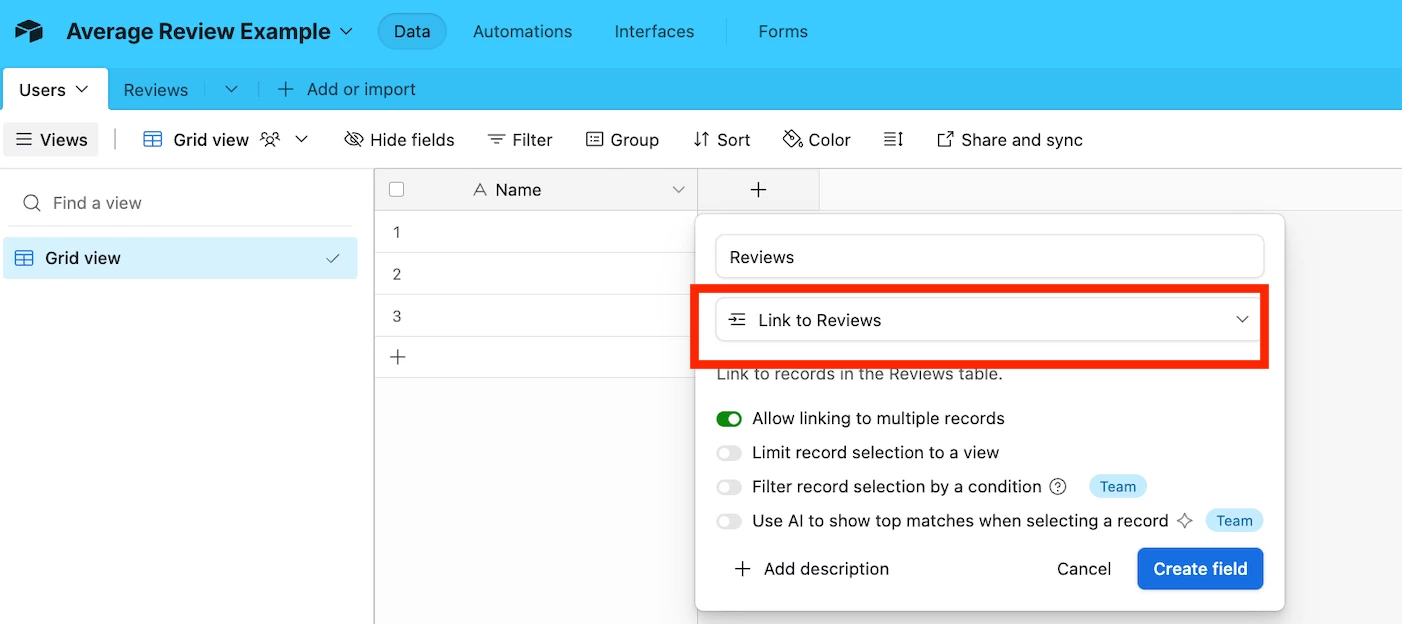

3. From your Users table, create a new field of field type "Link to another record.." and select the Reviews table.

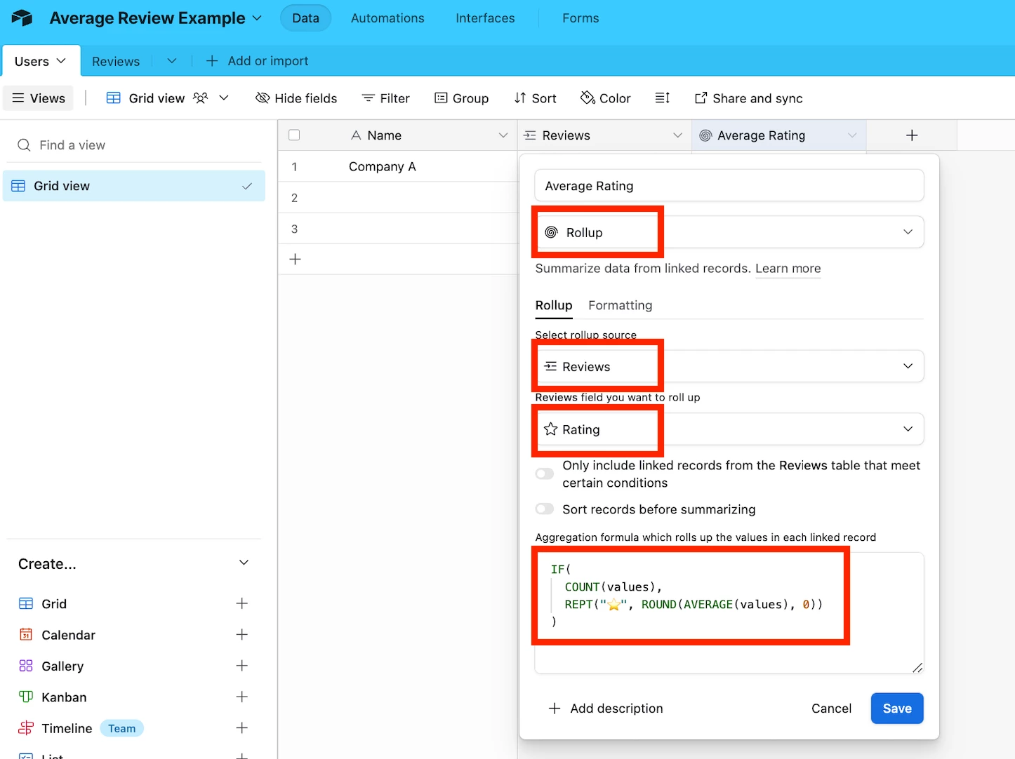

5. On your Users table, create a new field called Average Rating, of field type "Rollup". For the rollup source, select the Reviews table. For the field you want to rollup select the Rating field. For last, apply the formula as shown on the image below.
IF( COUNT(values), REPT("⭐", ROUND(AVERAGE(values), 0)) )

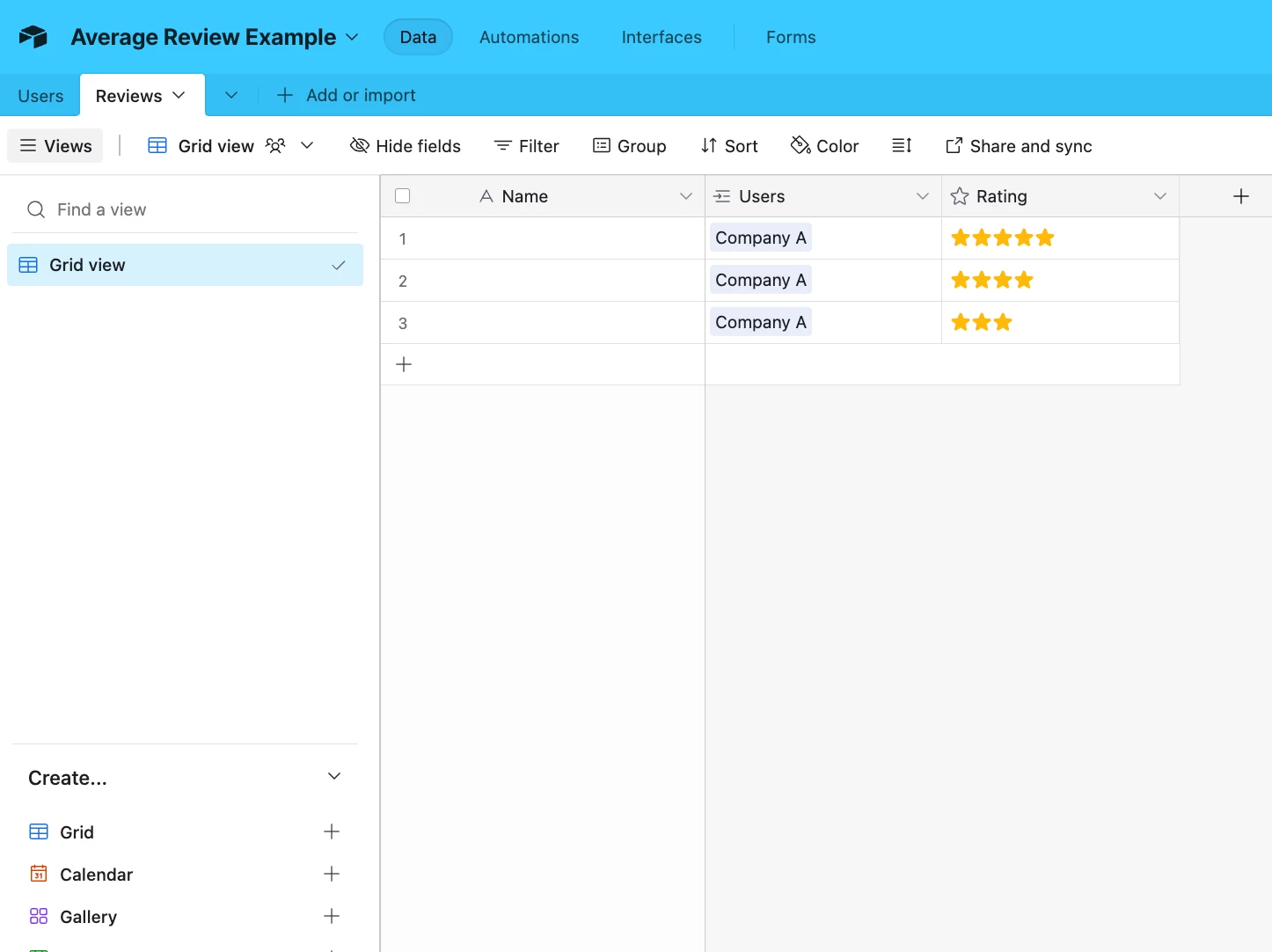

Assuming this Reviews:

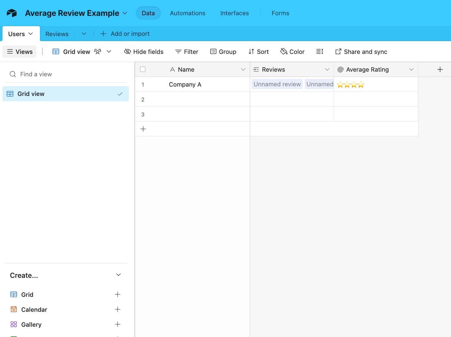

You'd get this average as a rollup:

Hi Mike,
Thank you very much, this has been very useful. I have followed your steps, and it seems my issues is that the linked record on the users table isn't automatically updating. If I manually add the users then the rollup works as expected. Do you know how to resolve this?
