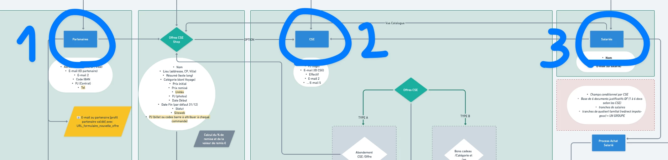

I am building a platform that includes:
- 1 [Partenaires] : they are shops who issue a commercial offer
- 2 [CSE] : they are companies who contribute to the commercial offer and offer an additional amount to their employees, their employees' invitees and their employees' family (these are 3 categories of beneficiary). The amount of the contribution will vary based on a beneficiary category.
- 3 [Salarié] : they are employees who can benefit from either a commercial offer, or an exclusive offer if their company contributes on the given offer.

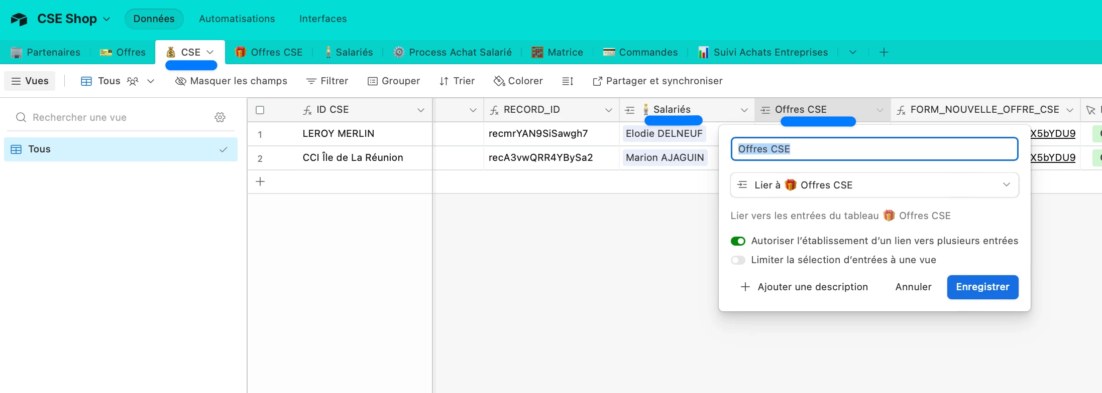

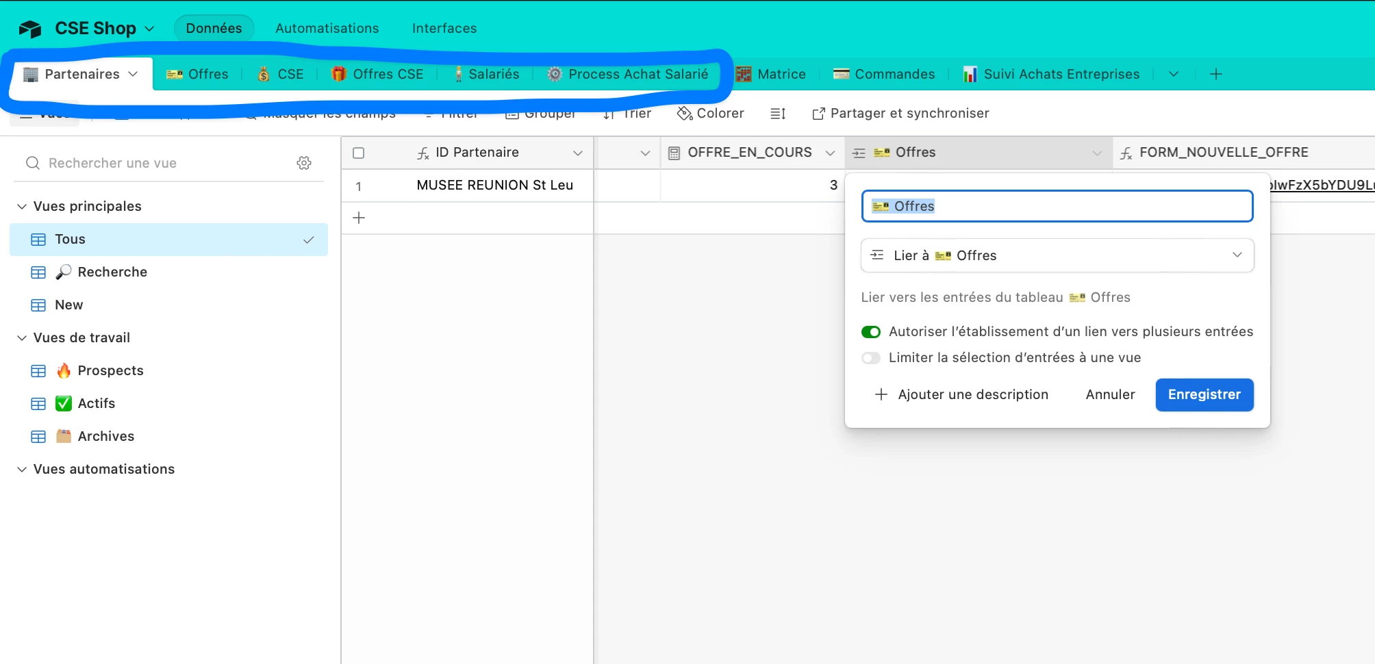

Of course, here is the link to the all base: https://airtable.com/appIwFzX5bYDU9Luq/shroXiapYg3SIsGXS
Only consider the 6 first tables (I rounded in blue)
And attached are the screenshots showing the linked tables.
The 🎫 Offres are the Commercial offers from the shops.
The  🎁 Offres CSE are the additional contributions from the companies.

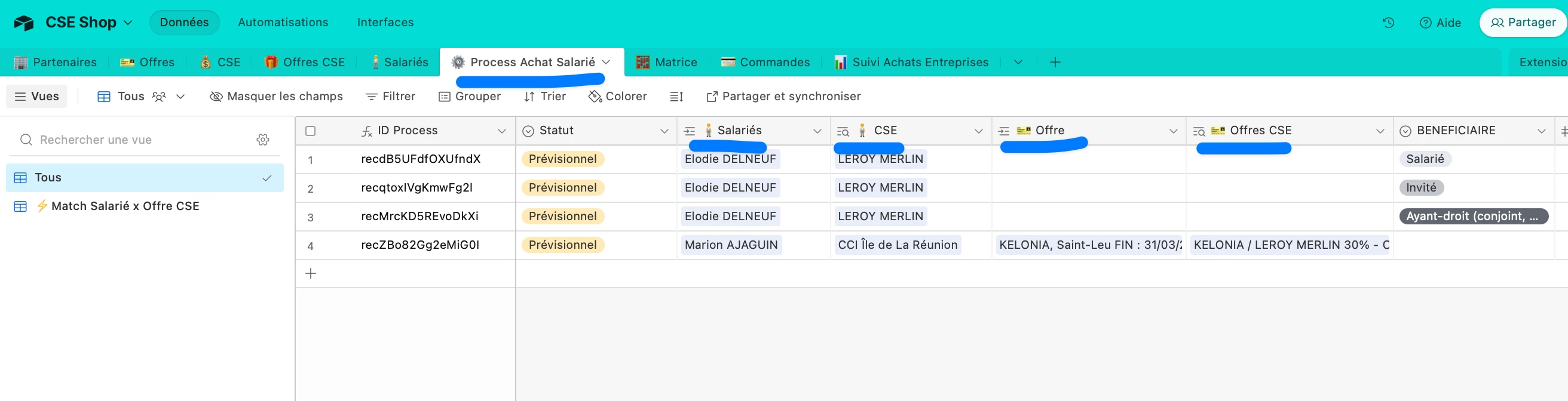

I would like the end result to be :
- In the table ⚙️ Process Achat Salarié,
- Based on the Employee, its linked company (CSE), and the beneficiary chosen upfront,
- Input (if there is one) the correct additional contribution (= 🎁 Offres CSE) in the column I rounded in orange in the screenshot named 🎁 Offres CSE. So I can then tell the employee how much there is left to pay.
I tried an automation to match employee with 🎁 Offres CSE but that only worked when I had one 🎁 Offres CSE for one 🎫 Offres. The beneficiary dimension (that leads to 3 potential 🎁 Offres CSE for one 🎫 Offres) changes everything.

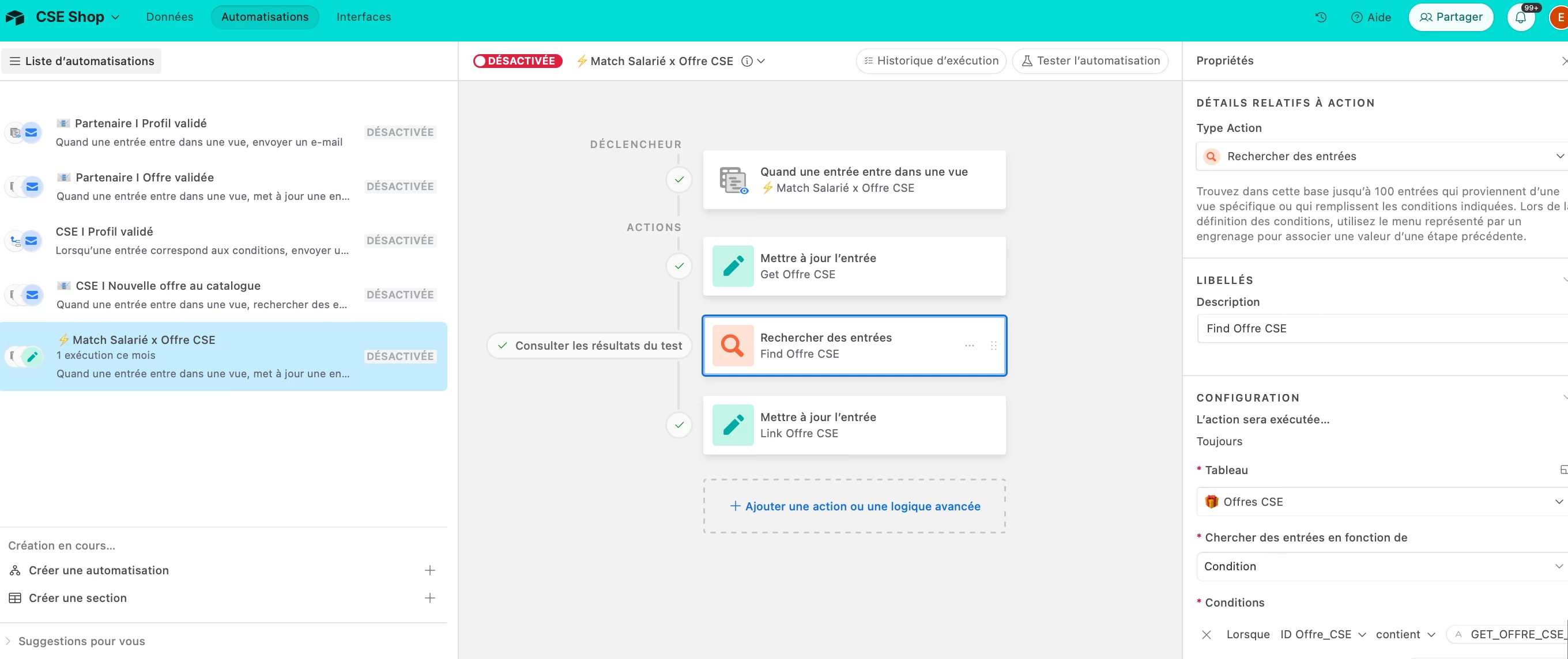

Ahh, thank you for the details!  If I'm understanding correctly, we want to find the appropriate record from "🎁 Offres CSE" that has the same selected "🧍 CSE" and "BENEFICIAIRE" entered in "⚙️ Process Achat Salarié", is that right?
If so, a Find Record action that looks like this should work:
Link to base
The tricky bit is setting up the linked record data, and you'll need to click into the linked record first:
And then select the linked record's ID:
Link to base
That's it! It works perfectly fine. I added a condition to find the appropriate record from "🎁 Offres CSE" that has the same selected "🧍 CSE" and "BENEFICIAIRE" and "🎫 Offre" entered in "⚙️ Process Achat Salarié"
