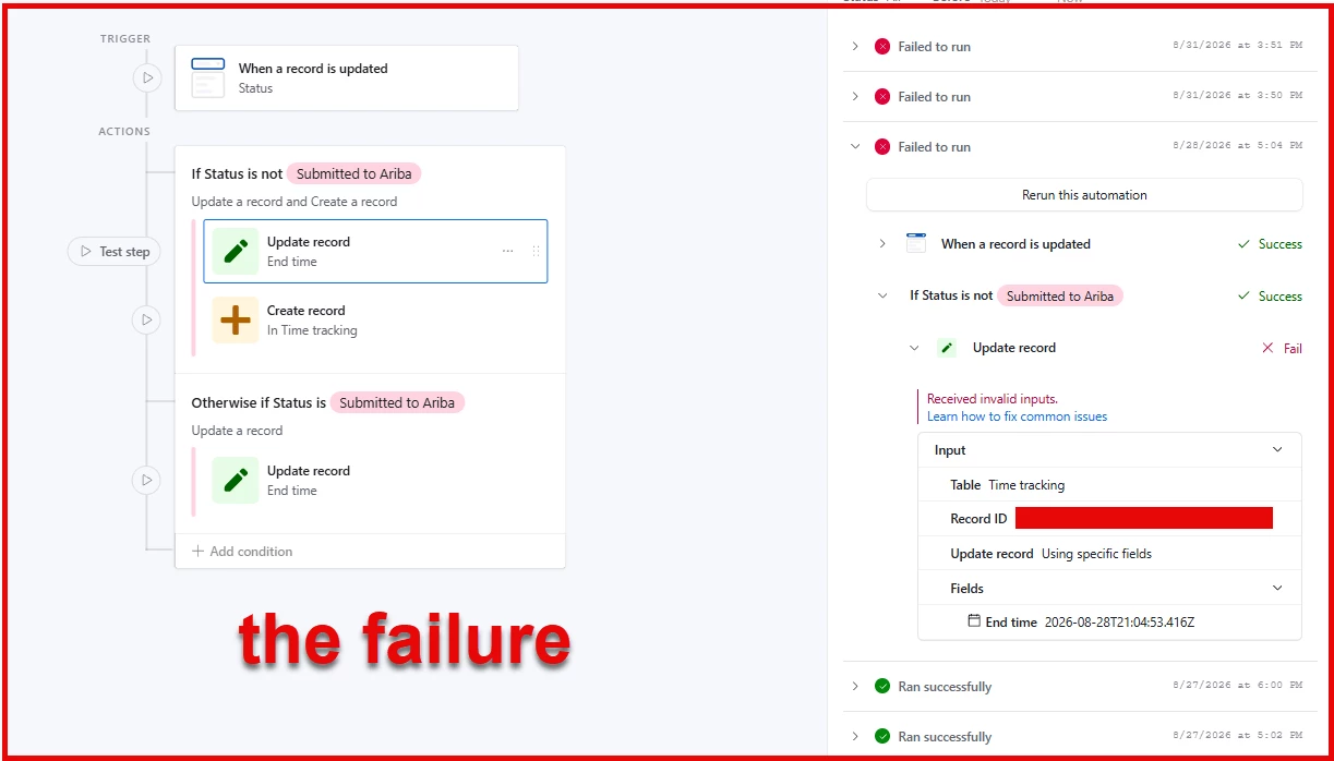

I have a base with a few tables, and an automation set so that when the status of a record on the Tasks table is updated, the linked record on the Time Tracking table is also updated. I’ve been getting intermittent ‘Your automation has failed’ notifications but all of the expected updates on the Time Tracking table are present. History log only ever says “Received invalid inputs”.
I’m not sure how to even figure out what the problem is.

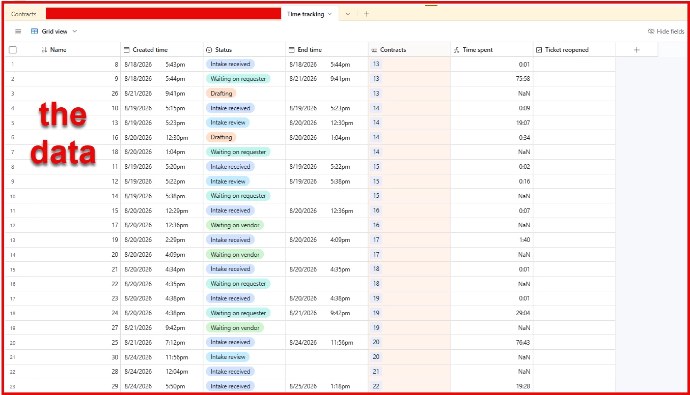

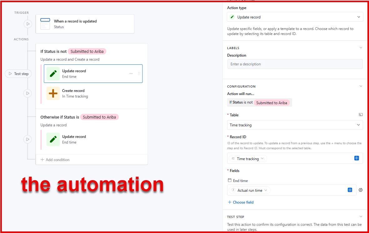

You are correct, it does not look like issue is with the End time value itself.  Look at the “Record ID” field in the Update record action it is not a literal ID, it has to be pulled from somewhere, likely a lookup on the Contract’s linked Time tracking field.  In your Time tracking table, each contract has multiple linked records.  As you can see contract 13 has 3 while contract 14 has 4.  A lookup through a link field always returns an array even when you only want the most recent one.  When a contract has just one linked Time tracking record, the lookup resolves to a single ID and works fine.  Once a second or third linked record gets created, that same lookup ends up returning multiple IDs, and “Update record” cannot use an array as a single Record ID, hence the “invalid inputs”. Kind of explains why you are seeing something intermittent and only later in a contract’s lifecycle.  What is actually feeding that Record ID field?

What you are most likely encountering is a race condition, especially because of the intermittent failures.  The automation fires but a field that it depends on, usually the link itself or a lookup or rollup field that pulls from the linked record hasn’t fully settled when the automation tries to reference it.  Rollups and lookups are one of the field types that can have a longer lag behind their source changing.  Try to add a short delay step before the update action and double check whether any field the automation reads is a lookup/rollup rather than a direct field.  That is usually what causes the “invalid inputs” that only show up sometimes.

​@anthonyXRay  I’m not sure if this would be a race condition, as I’m working with a linked record but not pulling any data from it - I’m just recording a time stamp. I’ve posted screenshots above.

In the failure screenshot, there’s a correct Time Tracking record ID in there I assume?  Any chance you could duplicate your base with no records in it and share it?

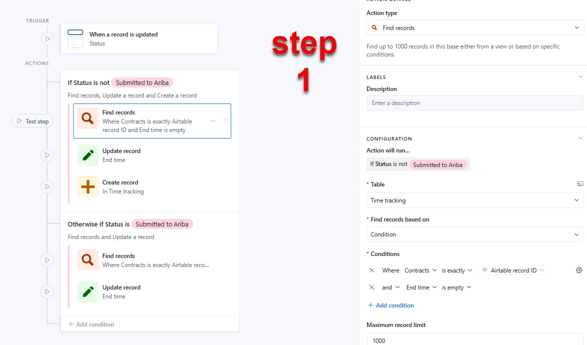

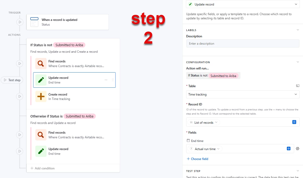

But I think ​@anthonyXRay has found my mistake. I’ve used this setup in an older base and I was trying to streamline the automation, but I obviously forgot the lookup to find the linked record on the Time Tracking table that has no End Time.
Here’s the updated version, I’m open to any other feedback or tweaks on this.
