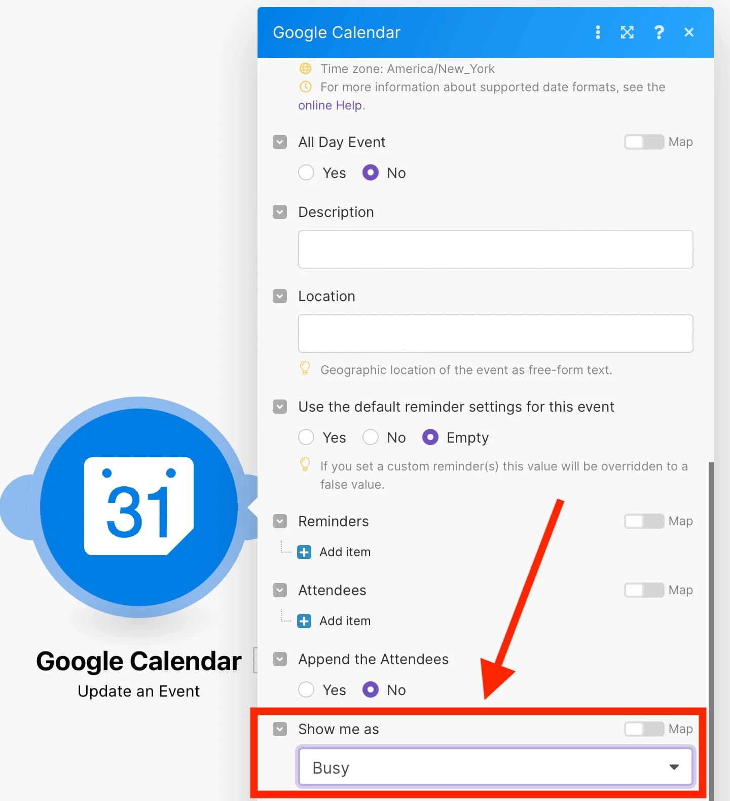

I only spent about 20 min testing it and could not get Airtable automation to work the same way as creating an All Day event in Google Calendar.
There is an additional app Make.com that you can use for free that can watch your google calendar for events created by Airtable, and flip that switch for you. Or remove the automation from Airtable and create the full event in Google Calendar for you the way you want it.
  • September 15, 2022
As @Vivid-Squid mentioned above, you can toggle this setting by using Make.com — check out this screenshot below:
