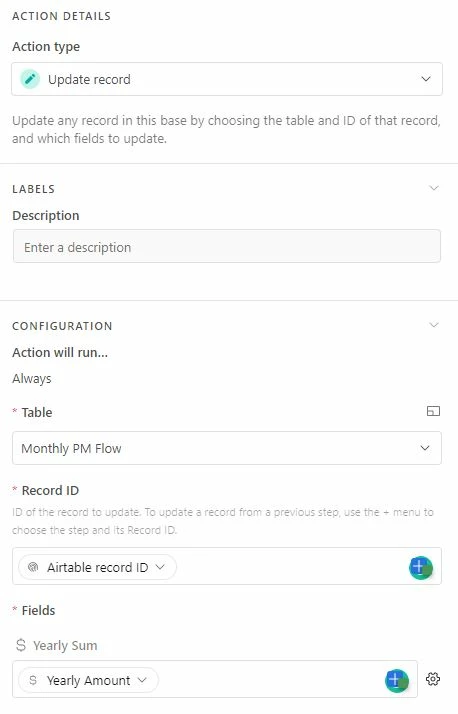

My Trigger - When a record is updated
Record to watch "Current PM"
Watch for updates in the field "Yearly Amount".
My Action -  Update Record
Update Record in table " PM Monthly Flow"
Record ID - I have chosen "Record ID"
Fields to be updated - "$Yearly Sum"
I want the "Yearly amount" field in the "Current PM' record to update the "$Yearly Sum" field in the "PM Flow" record.
It fails every time......... Help

Could you provide screenshots of the tables and the relevant fields?  Without that information it's hard to help with troubleshooting.
Do you have a linked field between the two tables "Current PM List" and "PM Monthly Flow"?  Where are you getting the "Record ID" value you're using in your action?

Hi Scott, thanks.  That looks fine actually, so I think it should be to do with the record ID bit.  I've set up a version of the automation that you're looking for here
And here's the tricky bit where you put in the record ID:
I was also wondering if we could just use a lookup field for this instead actually.  That way you wouldn't need an automation to keep this number updated, the lookup field would always display the latest updated number?

Ah no worries at all
So, first, we have a linked field between the "Current PM List" and "Monthly PM Flow" tables right?  (I'm not 100% sure you have this as I don't see said field in the tabble screenshots, but you mentioned earlier they were linked)
The way you've got your automation set up in your screenshots looks good, and the only thing you need to change is in the "Update Record" action, specifically the "Record ID" action
For this field, you will need to select the linked field to the "Monthly PM Flow" table.  After you've done that, you'll need to click on the pill itself:
And after you click it, you'll be shown another menu, where you'll need to choose to show the "ID" property:
This is basically saying that, when you update the record "Record 1" in "Current PM List", you want it to update the appropriate record in "Monthly PM Flow", and we're determining what's the appropriate record in "Monthly PM Flow" via the linked field
