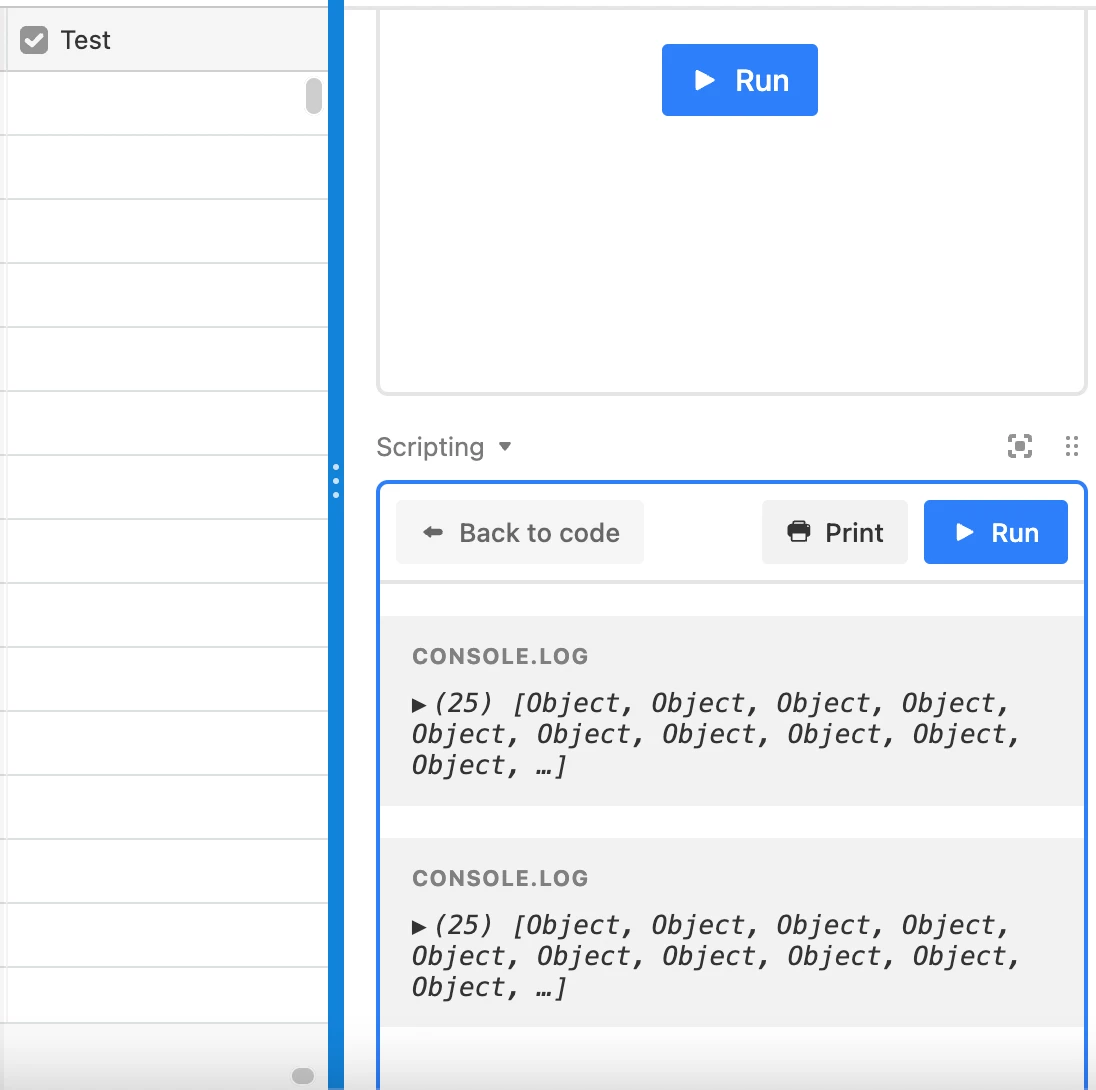

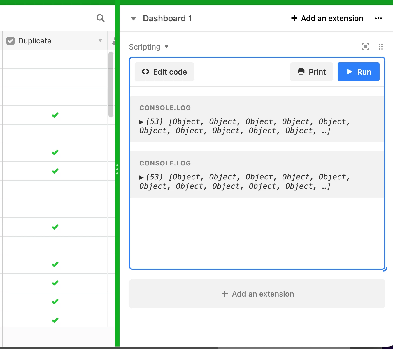

Hello,
I am working on an Airtable script to flag dupliacte records in a table and automatically flag them. But for some reason when I run the script, nothing happens. I have tried the script in another Airtable project and it works just fine but its not working here. Would be glad to know what I am doing wrong and how to fix it.
Here is my script
var tables = base.getTable("📊 Impact Data");
var query = await tables.selectRecordsAsync({
sorts: [{field:"Time",direction:"desc"}],
fields:["location_id"]}).then(result => result.records.map(rec => ({id: rec.id, field: rec.getCellValue("location_id")})))
let uniqueRecords = query.filter((rec, i, arr)=> arr.map(el => el.field).indexOf(rec.field)!==i);
console.log(uniqueRecords);
let updates = uniqueRecords.map(update => {
return {
"id" : update.id,
fields: {
"Test": true
console.log(updates);
while (uniqueRecords.length>0){
await tables.updateRecordsAsync(updates.slice (0, 50));
 uniqueRecords= uniqueRecords.slice(50); }
I have also attached records of the two projects (one where it runs and one where it doesnt work). Thank you in advance 😁
