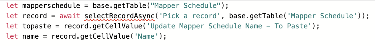

let mapperschedule = base.getTable("Mapper Schedule");
let record = await selectRecordAsync('Pick a record', base.getTable('Mapper Schedule'));
let topaste = record.getCellValue('Update Mapper Schedule Name - To Paste');
let name = record.getCellValue('Name');
output.markdown(topaste);
if(topaste!=""){
    await mapperschedule.updateRecordAsync(record.id,{
        'Name': topaste
output.markdown('# Done!');

thanks, here it is
if(topaste!=""){
        'Name': topaste

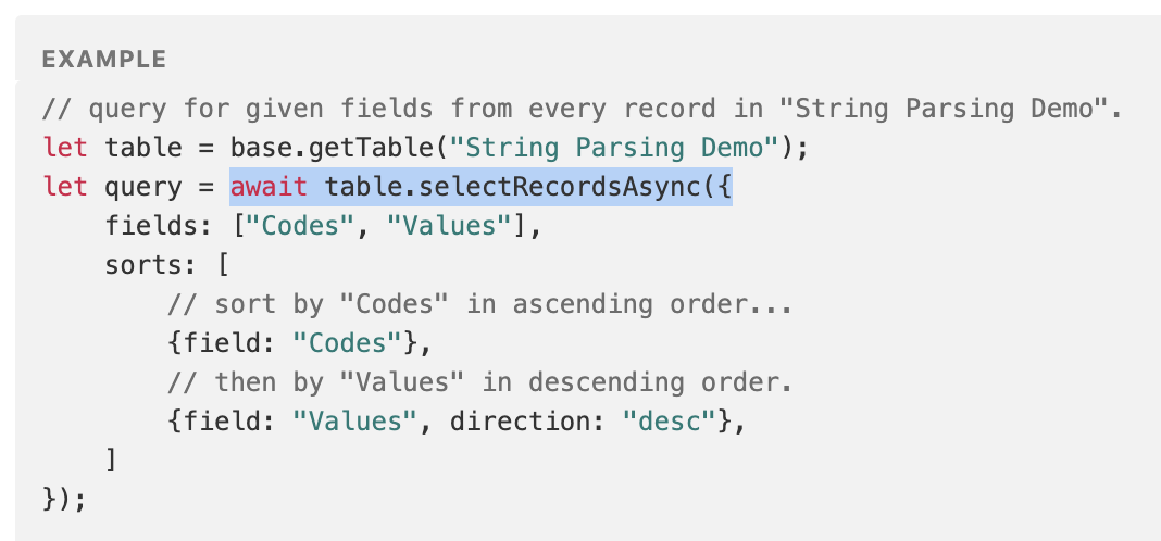

If you look at your script in the editor, the location of the error is made obvious with the red underline.
The documentation for selectRecordAsync indicates that it is a method of a table and no table is declared for this method in your code. Essentially, the script is struggling by asking - … you want to select a record from where exactly?
The example in the documentation shows how to use this method.
As such, you need to place the table object in front of the select method like this.
let record = await mapperschedule.selectRecordAsync('Pick a record', base.getTable('Mapper Schedule'));
You can also simplify your code for this by referencing the table object in the second parameter like this:
let record = await mapperschedule.selectRecordAsync('Pick a record', mapperschedule);
