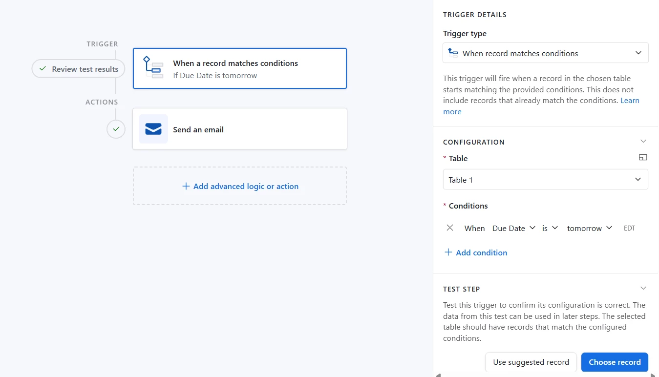

I’m trying to create an automation that sends an email to a table user when a “due date” field is tomorrow.

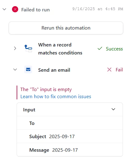

The trigger and action tests both get green check marks but when I turn on the automation, it shows a fail in the history because there’s nothing in the “To” field. It all looks like it should work so I’m not sure where I’m going wrong. Has anyone been able to make something like this work?

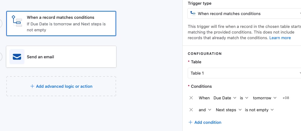

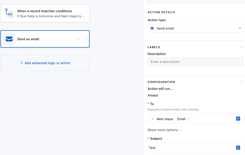

Hm, add in an additional check so that it also checks whether the ‘Next step’ user field is filled?  Looks like it’s triggering on a record where no Next Step is set
Here’s a base with a working version set up
